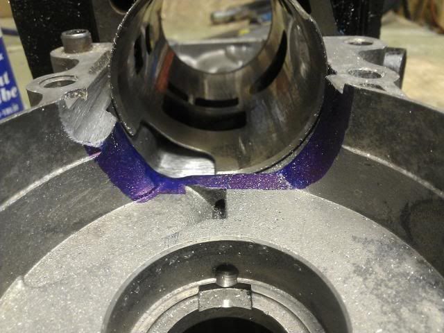

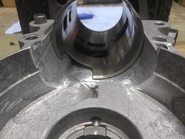

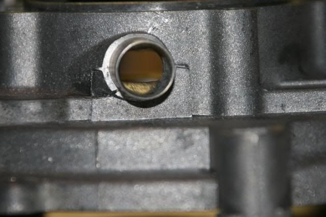

Inspired by some of Your own!
~M28 mei 2014 om 12:02 #148231I hope I’m wrong but the inlet looks kind of big.
There’s a possibility that the crankshaft won’t be able to close it off.I can also see some scratches to the place where your bottom gasket should be.
Hopefully these scatches aren’t too deep, otherwise it might leak.
Next to that, the right side of the bottom image shows a fairly small edge to clasp your gasket.
It might be enough, but there’s a possibility your gasket will blow out.Still, I hope I’m wrong…
Welkom op ons forum!

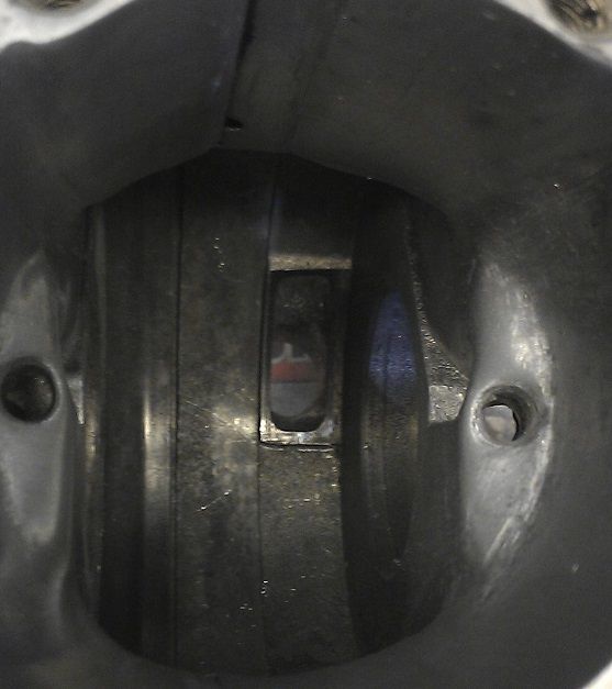

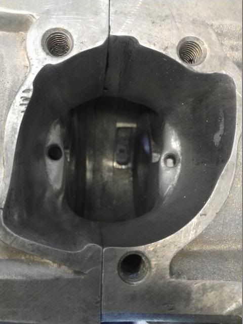

Breng een bezoekje aan mijn Ciao project.28 mei 2014 om 17:11 #147631I think it’s pretty good(inlet i mean), also connect this inlet to me well.
Maybe a better picture of the inlet?

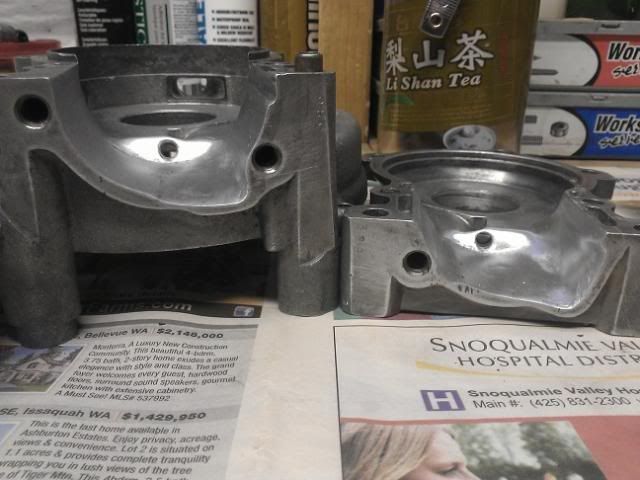

28 mei 2014 om 17:41 #148230The upper side (left on the picture) looks a bit to far to the edge. Have you tried putting a crankshaft in and see if it closes off the inlet completely?
28 mei 2014 om 17:53 #148210Inlet does seal (I do have the bike put together and running already (http://vespa-ciao.nl/forums.php?m=posts&q=34469). Here is a better picture of the inlet window:
I have made one too wide before to where I could see light coming around the side of the crank lobe, so on this one I left at least 1mm overlap on each side. The previous crank broke after I hit my variator on something and rubbed against the sealing surface as well, but it still seems to seal pretty well. This was My excuse to go ‘big’ on the case porting this time around.
