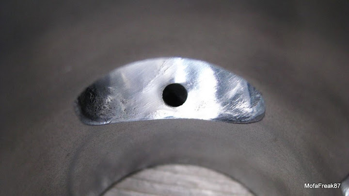

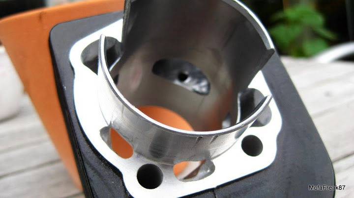

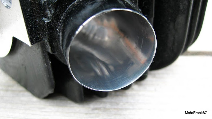

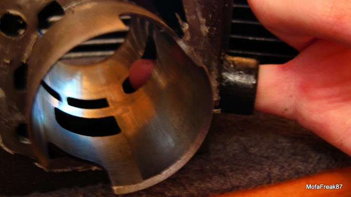

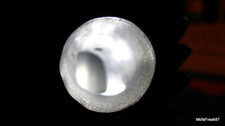

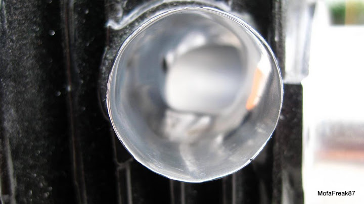

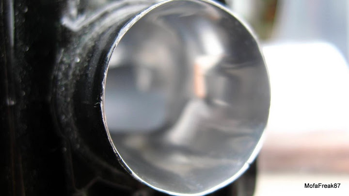

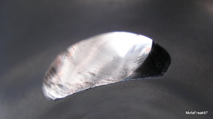

        today i tuned my pinasco because i was exrtremely boared
        look yourself

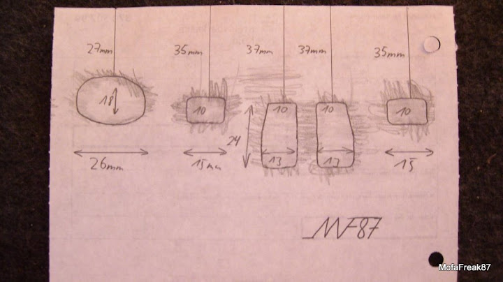

        in the beginning i made the channel bigger
        in the inside its bigger than 20 to 21mm
        then i polished it
        before i drilled the outlet my little finger goes through it
        now my middle ring and show finger goes through it
        and my little finger can go through it without touching the wall

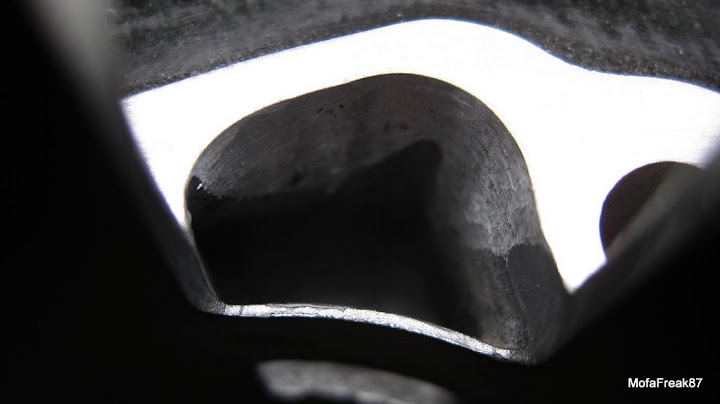

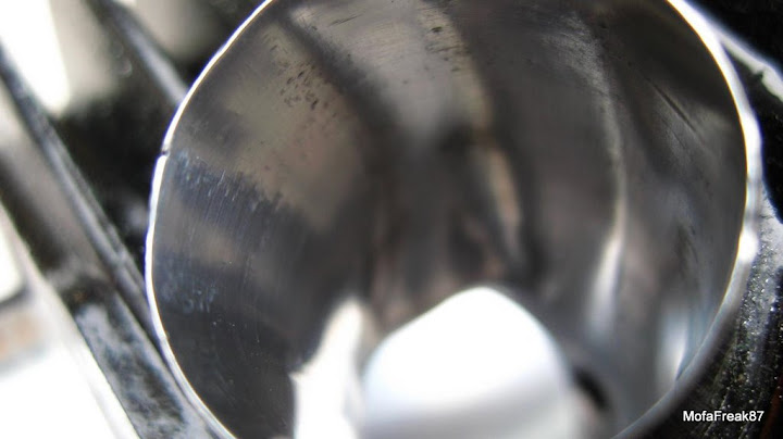

        before after

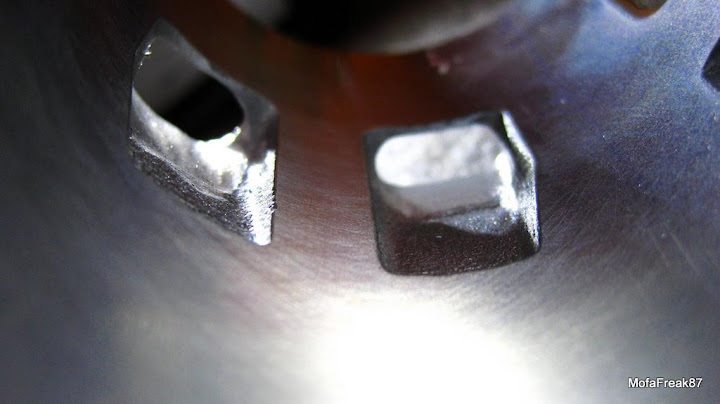

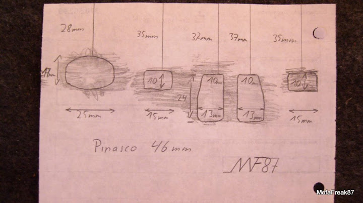

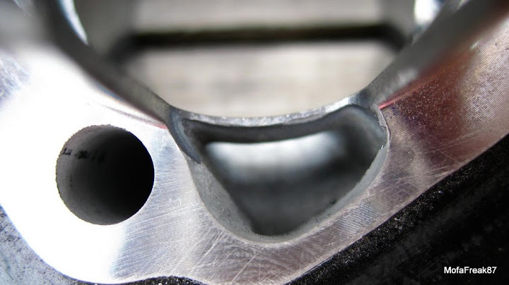

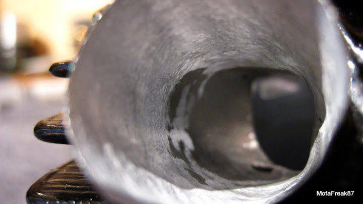

        now the boost and main channels
        before after

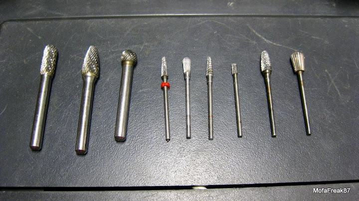

        the tools

            geil, but your exhaustport is very thin. I think it’s gona break soon. But nice tuned!
            #453720
            MofaFreak87
            Berichten: 224
              you underrate the thikness of the exhaust
              i made it verry thinn at the beginning but when you go more back its getting thicker
              round about 1,5 mm
              i think this will work good
              when not no problem hehe ^^ then i weld a bigger outlet on it
