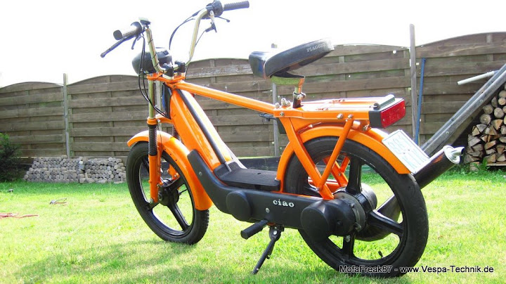

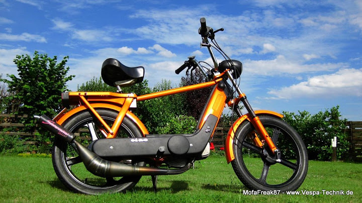

      today i proudly present my Ciao ST
      it beguns before jears ago with this old ciao
      then i was a bit stupid and painted it myself in black
      it was paint out of the bottle…. but there was no Jini in the bottle
      so the paint was soft and gets fast small scratches
      after that i made step by step to made it better and better
      first there must be a new frontend
      then a pipe between handle bar and seat
      here and there and here and there
      after allot of work and blood i made it to my Ciao ST
      i was more than 2 jears dreaming of that coloure
      and now was the time to do it finally !
      i was sandblasting and wleding all the parts by myself
      allot of work how you know hehe
      here is the video from the beginning and everrything i made
      and here is the result
      greetz from germany, Marc

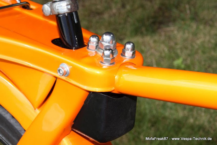

            Smooth ciao!
            Calibrata :rules
            I Like the way you attached you’re frame “tube?” It’s nice and custom made!

                    Very nice ciao Marc! I really like the metallic orange painting, looked very nice on the VCT.

                      @ von hirkebosj: thx allot dude :lol
                      @ docs911: ich selber hätte auch nie gedacht das es soviel wird =)

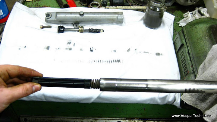

                      @ Helios: thx, was also allot of work but now its strong and looks good 😉

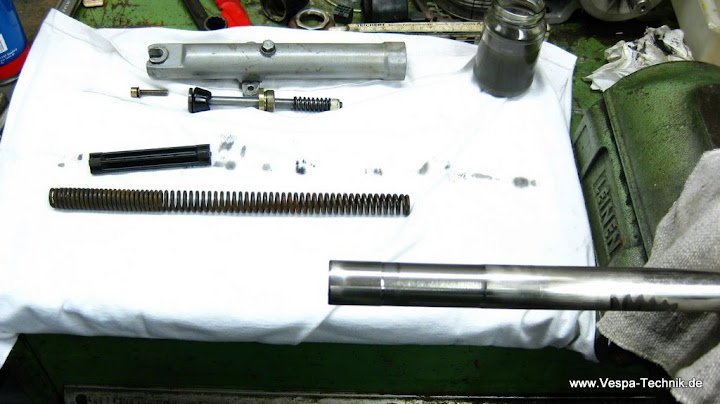

                      @ SpeedDemon: aaaalso … das war mal eine bravo gabel.. so sah sie mal aus
                      dann wurde sie abgedreht auf der drehbank und die neue stange wurde eingepresst und dann schön verschweißt
                      auch wieder viel arbeit hehe

                      @ Bartjee: jeah it was okay on vct 😀 but wothout the red tank and the backpacks it looks MUCH better

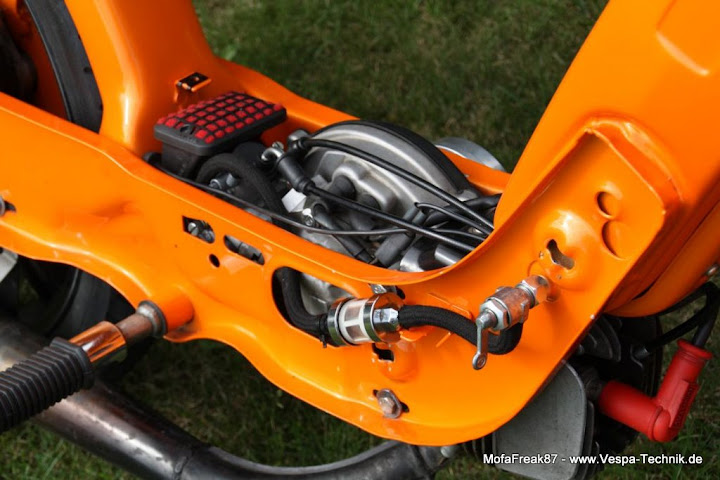

                        Built up very nice, with alot of attention for details as i can see
                        not to mansion that the setup is insane aswell 😀
                        and the color is lovely, i’m looking for a colour of this kind for my upcoming racer 😉

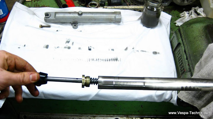

                            Ganz geil, ich hab nog nie ein Bravo Gabel gesehen. Sind die Feder auf die Gabelachse standard oder schon wieder ein “Custom-part”.=)

                              @Poelll13: thx allot ! when you wanna know the name of the coloure no problem: Electric Metallic Orange from the Ford Focus ST
                              nice colure but verry hard to paint ! you need allot of paint because the colure is like water !

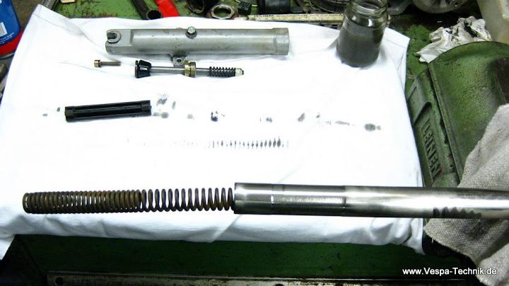

                              also ich habe INNEN und AUßEN liegende federn.

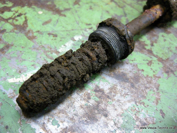

                              die innen liegenden federn sind aus einer SI vordergabel die ich mir hart erarbeiten musste da die komplette gabel eingerostet war
                              also sind das orginale und standartmäßige federn
                              i used springs which are inside and outside of the fork
                              the springs from the inside are from a SI fork which i had hard to work for because everrything was rosted
                              so these are std springs 😉
                              you can look here :
                              http://picasaweb.google.de/MofaFreak87/Gabelumbau#
                              und so sah die gabel von der si aus wo ich die innen liegenden federn her habe
                              jetzt könnt ihr euch den rest vorstellen
                              and this is a photo of a part of the SI fork… now you can think by your own how the rest was looking

                                Ja, so sahen meine Federbeine auch aus. Ich meinte die Feder um die Federbeine ist das ein standard Bravo teil?
