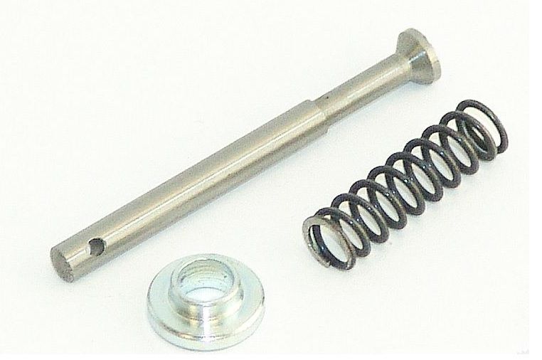

          Whats the difference on these two decomp kits?
          Which one will you recomend me to buy?
          http://www.jmpbparts.com/decompressiestift-veer-citta-ciao.html
          http://www.jmpbparts.com/decompressieset-citta.html
          #497048
          DarkMagician6
          Berichten: 932
            The first one is only for Malossi cilinder heads according to JMPB. I believe only for the 47mm head, not the 43 one.
            The second one is for regular cilinder heads.

              #495106
                DarkMagician6 :
                Yes you will need the second more common one, but the Malossi decompression is not only for the 47mm head. It will also go on any other DEPS or Ipermatic replica heads.

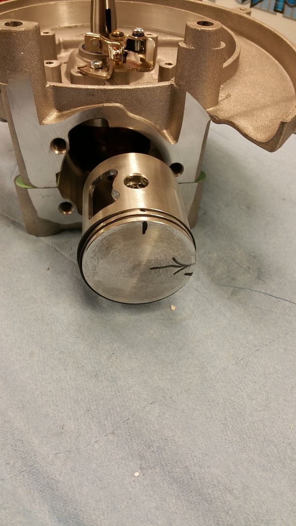

                        More questions.
                        The screw treads you see in this picture is missing from my Polini cylinder.
                        How do you fasten the top cover without this screw?

                          Italjohn
                          Berichten: 138
                            Aha 😀
                            That clear things up, thanks 🙂
                            Maybe my Bravo have this clip already??
                            We will have to wait and see when I have taken the engine out of the frame.

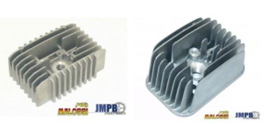

                              Can someone tell me what is the differece between these two heads?
                              My Bravo original engine has the small one to the left.
                              My Polini engine has the one to the right.
                              Will this still fit in the Bravo?

                                Difference is the cooling fans but doesnt matter mucht for your bravo take the one on the left with side fans.
                                  Ok, but I have bougth the Polini cylinder with the long fins, will this fit without any probelems?
                                  What about this “slack” between the piston and bearing?
                                  Is there any “shims” that make the bearing stay in the center of the crank?
