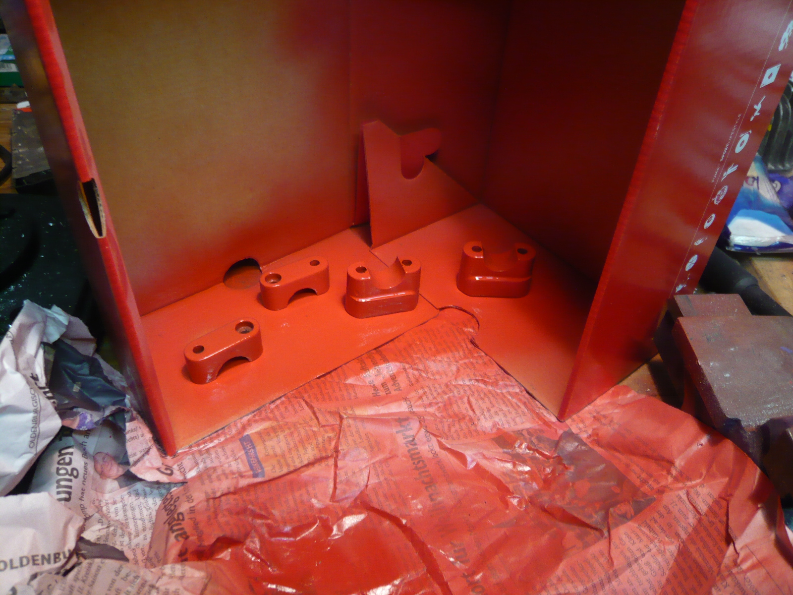

      I thought about a better fixing for my stuur on the Bravo fork.
      This thin brackets are not very stable.

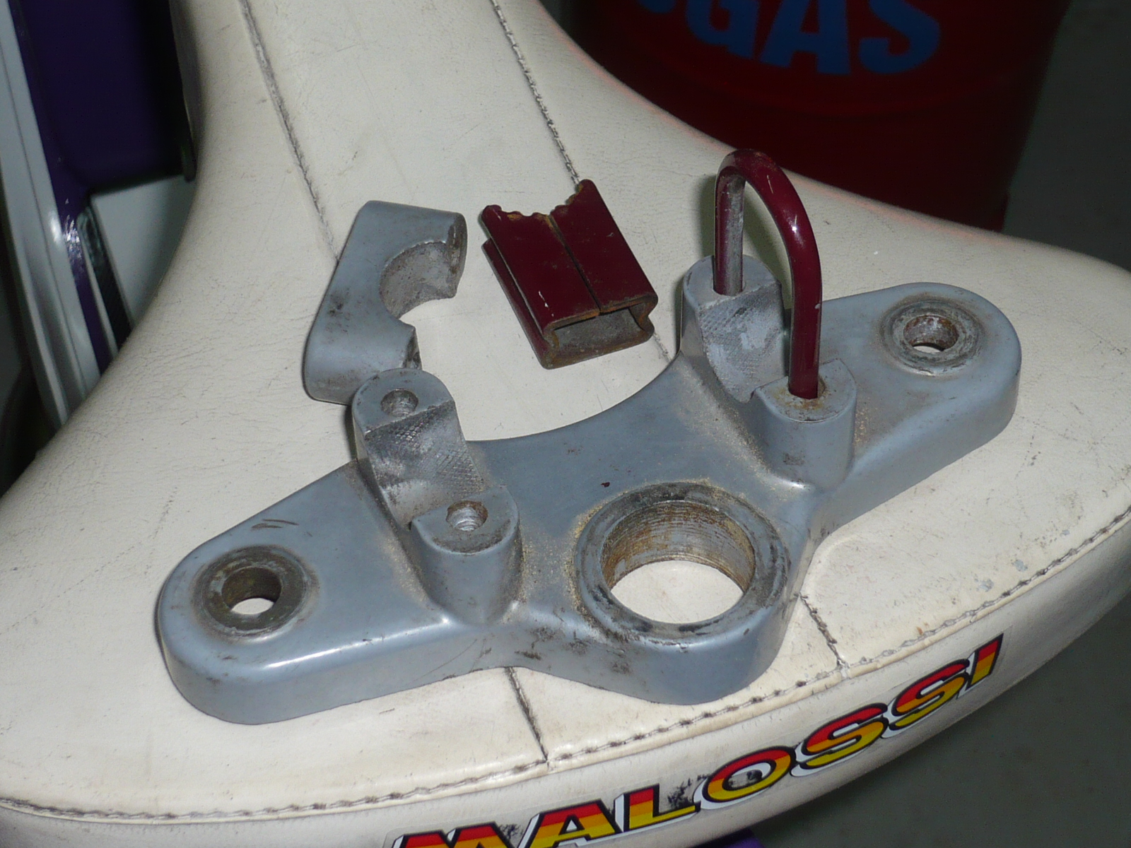

      Looked at a Si fork bridge. This thing has the same hole distances like the Bravo bridge
      Cutted it into pieces 😀
      and reworked the edges with a grinder. After that, tädä, new very solid brackets for the stuur
      some nice color on and finished

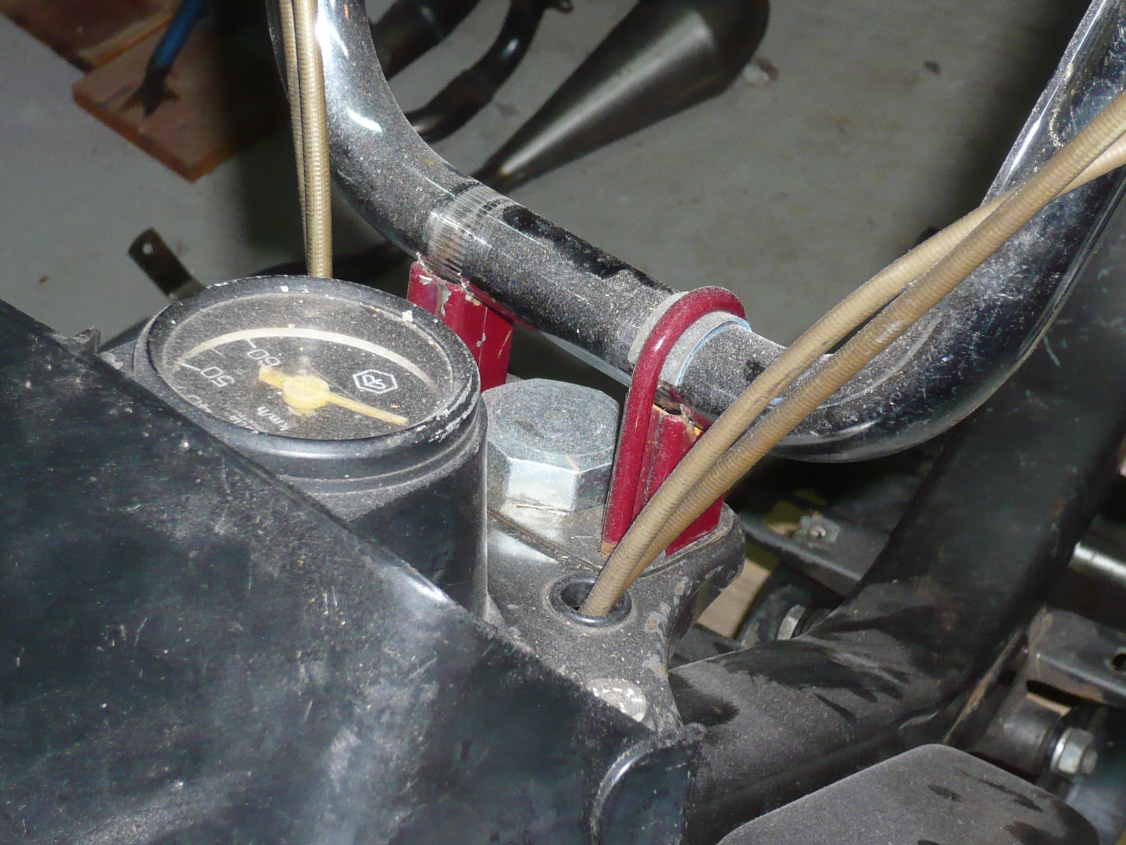

        nice work, i replaced mine with clamps from a tomos a35 fork, and mounted them where the cables go trough.
        nick
        #143878
          Nice job, but I never felt any instability:?
          #143879
            hehehe, but I did, as the threads on the wire ends were not longer ok after I screwed the nuts strong.
            Also I could move my stuur front and backwards. Maybe the stuur diameter is not thick enough. But with the Si brackets everything is perfect:D
            #143880
              Yeah i think the original one’s are good for the road. Not for crossing and jumping:D
