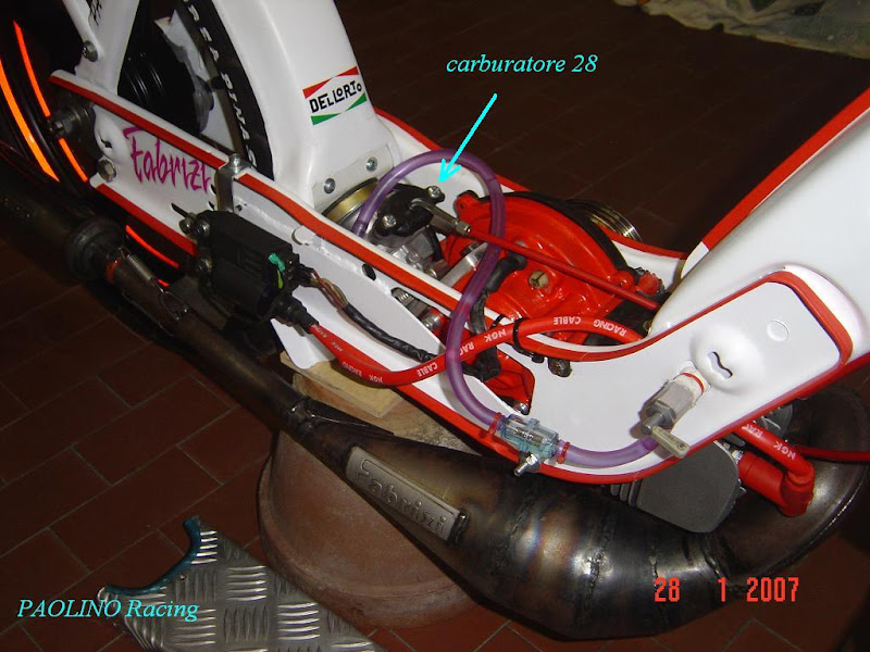

          terrydean
          Berichten: 98
            awesome! i looked forever for at least some photos and i failed, thanks so much for posting some! what kit is on that white bike, do you know? 28 is huuuuge!
            it looks like the white bike’s motor is moved further forward to make room, is that correct? i was considering that, but i’m not sure what i would do about belt length then. i was thinking of rotating the motor, pitching the front down and the rear up, ever so slightly, just enough to make room for the carb.
            i knew you could probably stuff a bigger carb in a cita or possibly other vespa with a subframe swingarm, but i figured ciao would be more difficult.

              He made a hole in the frame/rear fender. I believe he ran a 46 eurocilindro.

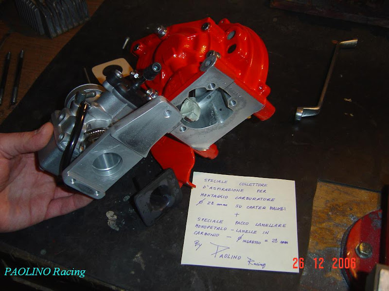

                        Where can you buy one of these intakes? I searched for “Paolino racing” but couldn’t find anything…
                        #147850
                          It’s custom made, I believe ‘Paolino racing’ isn’t a shop or a brand either. I met the guy last year and he’s quite a handyman, I’ll look for his new project pics on ciaocrossclub.
                          The manifold isn’t that difficult to make, fitting everything in a ciao frame is.

                            Thanks! 🙂 How much do you think he charges for this kind of work? What modofications need to be done for fitting everything into the frame?
