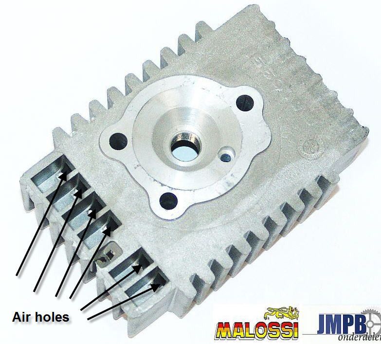

Italjohn reageerde in het onderwerp Italjohns Bravo 1984 (English) in het forum Projecten 10 jaar, 1 maand geleden
Is there supposed to be air holes in the cylinder head, like this on the Malossi.
I see that most of the Citta heads dond’t have these holes???
No holes in the Polini head??

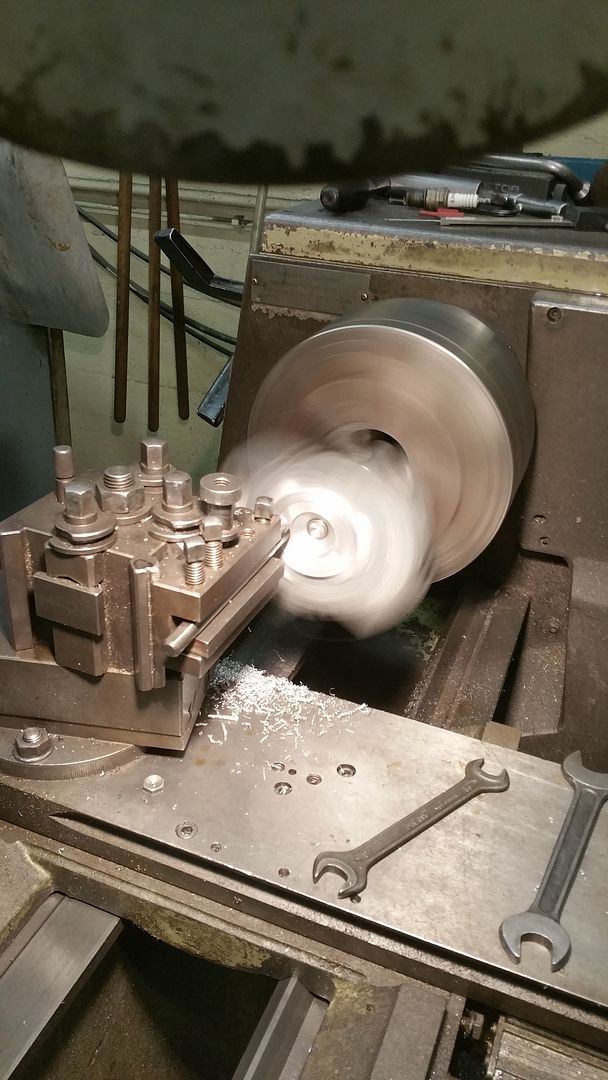

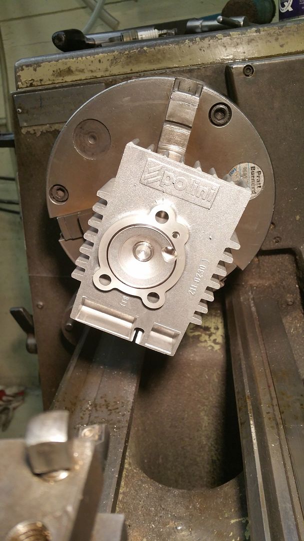

I have done some work on the new Polini head.
Machined from 41mm to 46mm 😀

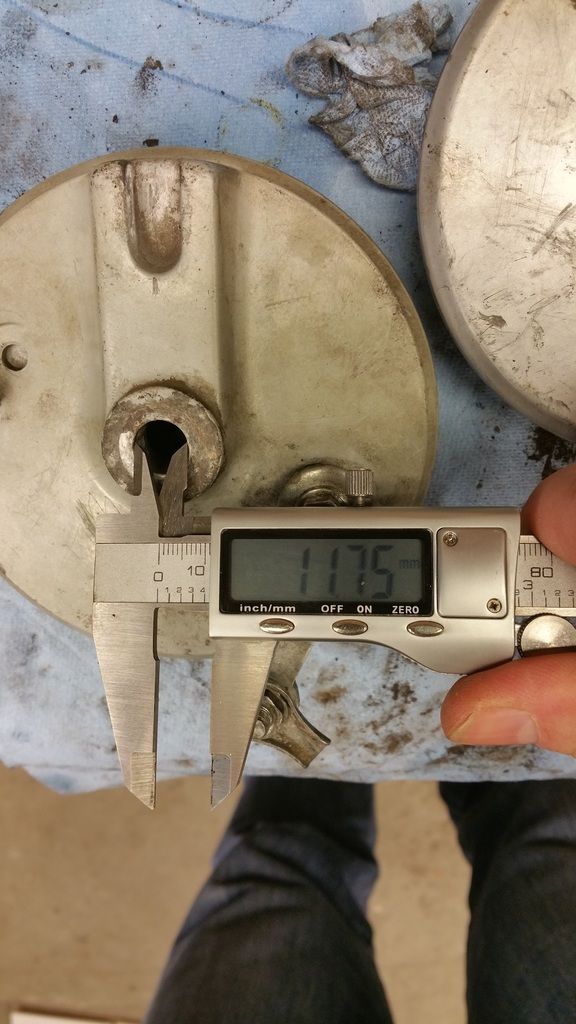

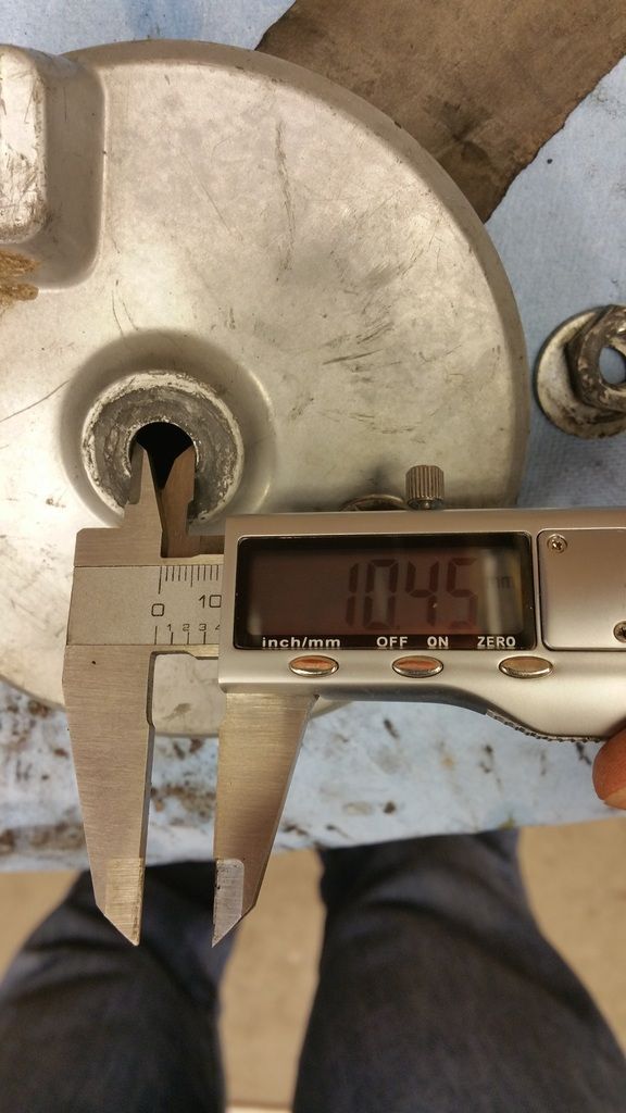

Anyon know why the Bravo front brake hub has a 12mm hole, and the SI brake hub has a 11mm hole?
My original Bravo hub also have this 11mm hole and axel.JMPB sell only the 11mm axel, no 12mm?
http://www.jmpbparts.com/vespa-ciao-si/frame-parts/mounting-material/voorwielas-cpl-citta.html
