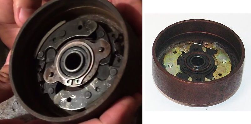

Same problem like in the video. Everything´s ok till i put the metal plate on the clutch. Crankshaft doesnt go around with the metal plate, without it go around. What the h…! Help me

1. You need the “ring met opstaande rand” between the cluth and the flywheel. see: http://www.jmpbonderdelen.nl/vespa-ciao-si/motordelen/koppeling/koppelingsring-citta-ciao.html
2.The pads inside the clutch bell are supposed to be the other way round.
3. The belt must me tensioned, because the rear wheel turns the belt. If the belt is not tensioned it will not grab on the clutch bell.
4. The 3 clutch pads are worn.
5. The plate you mount at the end might be damaged, replace it when possible.
6. Shoot us some more video’s 🙂
31 augustus 2015 om 19:40 #146479The clutch shall not engage yet, it’s the starter “shoes” the must engage first.
Thats the two “shoes” inside the clutch.
If you have dismantle them, you probably have installed them the wrong way around.
I did the same on mine. Try to install them 180° and try again.Edit: From the video the shoes looks like they are installed the correct way around.
31 augustus 2015 om 19:40 #146478hero on camera, love it 🙂 wilk explanned your problem. Maybe its easiest to buy a complete new clutch, http://www.jmpbonderdelen.nl/citta-onderdelen/motordelen/koppeling/koppeling-compleet-citta-ciao.html
31 augustus 2015 om 19:51 #145548I think i’ve already seen this video on mopedarmy? But as Wilk already explained. Fixx al of these problems and don’t forget all the other plastic cooling parts for your motor. You already mentioned this yourself. With the two starterclutchpads turned this way it will not grap on to your clutch. Also get a new right size belt. With the one on the video starting the moped will be difficult.
Although the 3 clutchpads looks a little wornout, these might go on for many more miles.
Point 1 till 3 from Wilk are the most importand to fixx first.31 augustus 2015 om 23:39 #146693Nice vid

1 september 2015 om 07:25 #146694Hello everybody. No the video is not mine just found it on the YouTube, but the problem is same. Yup the PROB were the inner pads/shoes wrong way around 😀 i was … blind. Thanks a lot guys. Keep in touch
