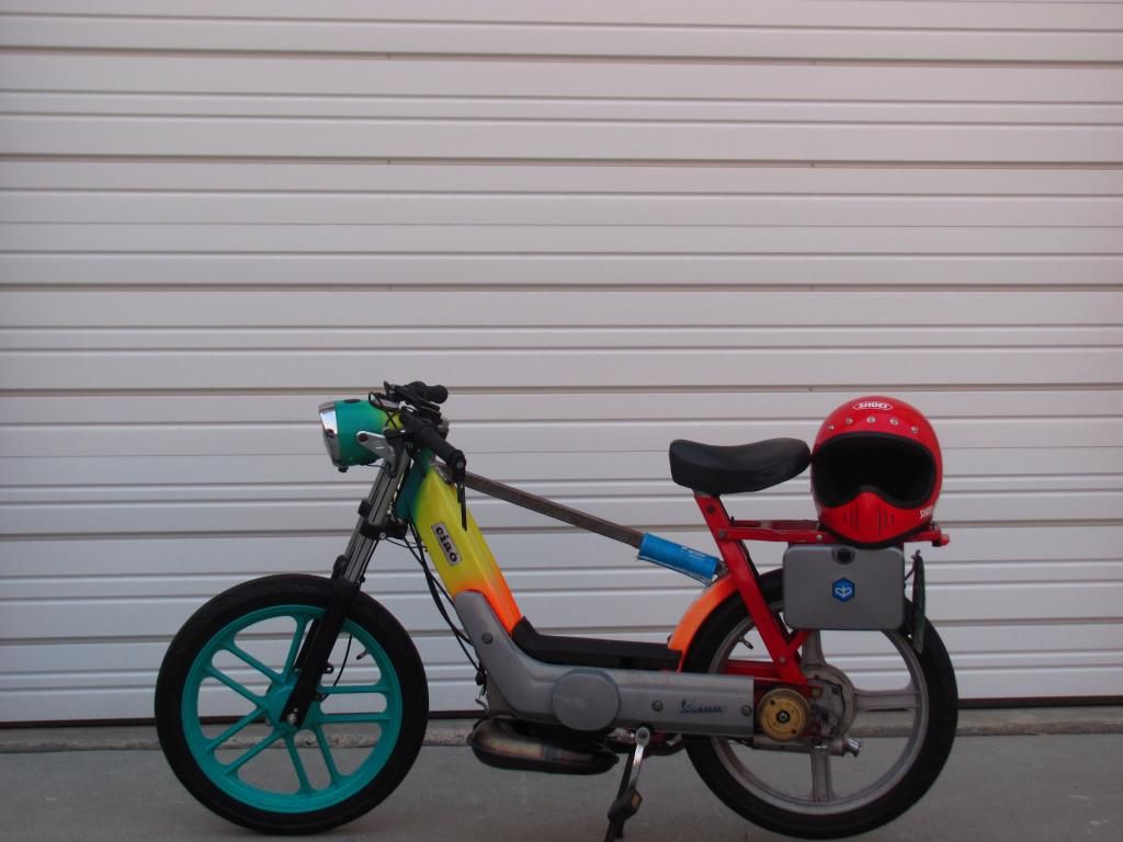

      I finally finished putting together this ’72 Ciao. I am really happy with everything performance wise. Pulls really hard and tops maybe mid-high 30’s. I have a working tail light w/ brake light wired. The tail light is led. The headlight is a sealed 6V and works.

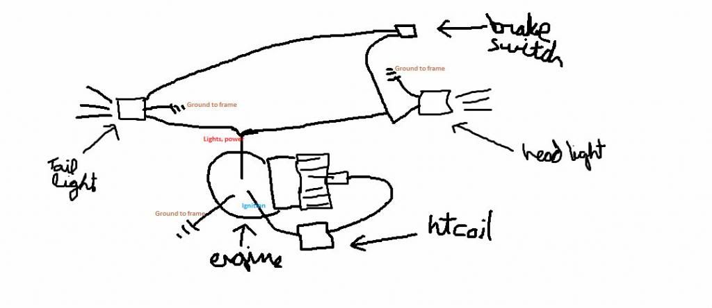

      When I ground the headlight, it cuts the motor. I have grounded it in several spots (including the headlight bucket, engine mount bolt, cross bar, and the forks) and it will still cut the motor. I have hooked up just the tail light and it works without cutting the motor. I am stumped. I hope someone will be able to help me out with this one. Thank you.
      Specs if interested:
      -stock crank
      -64 Malossi, Malossi head
      -Case matched and intake opened
      -13.13 w/ 66 jet, Malossi high-flow filter
      -Techno Stinger pipe
      -Malossi variator, I think ~48gr
      -Malossi contra spring (yellow), not sure on gearing
      #145243
        Eletronic or contact points ignition ?
        This scheme is for electronic ignition

          I have stock points setup. Everything is hard-wired. Here’s the way it’s wired. Thanks in advance.
          Chris.
