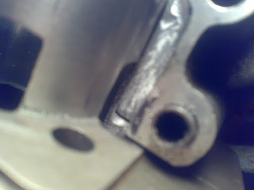

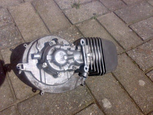

                    the speed engine runs like cow shit.
                    now i ride a 43mm Zeta on a tuned carter with 13er carb. mallossi luchtfilter, standart kruka, and polini sp
                    top speed 75kmh but the throtle is not sooooo good.
                    with a proma city power ist the throtle much better but the top speed is 60kmh and that ist not the best.
                    zeta 43mm the cylinder in my signatur
                    and that ist the carter
                    #512476
