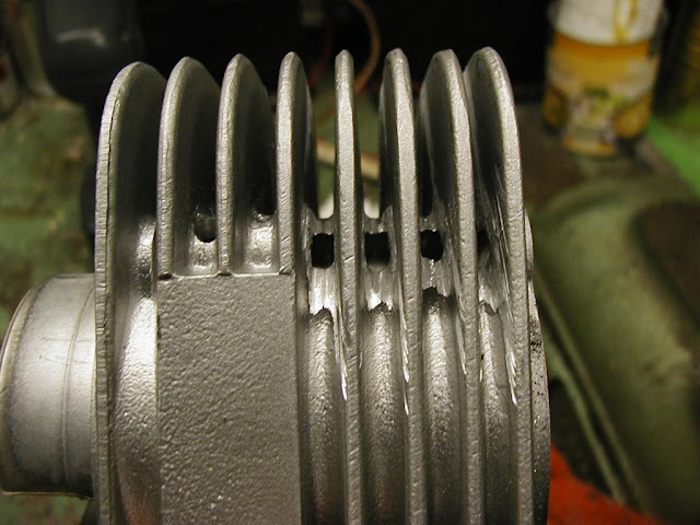

                                  Andree, I have seen the same symptoms on an Athena cylinder. Due to bigger mass around cylinder pin holes the expansion at heat in this areas is bigger then at the rest of the cylinder. The particles you found can be a result from that piston pressing in that areas.
                                  I know some people who opened the cylinder pin channels like on the pic here to reduce heated mass in that areas.
                                  If I see that I will open my cylinder pin holes in advance.
