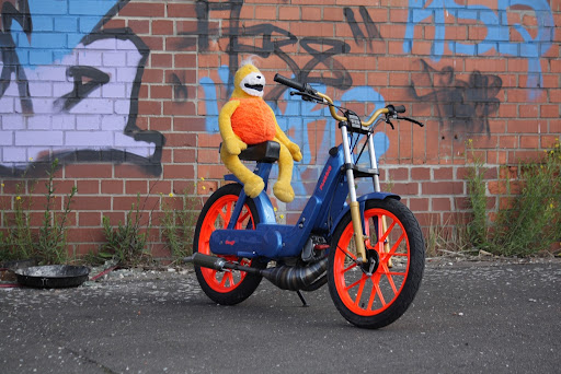

                Your GP is very cool! It only needs a flat beat to complete the picture with Flat Eric haha!

                  You can see the Ciao GP on next meeting in Thorn 17.07.11

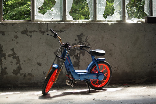

                    I like the gp ciao but the gold painted parts had to be black :P. The colour gold doesn’t fit at all in the colour scheme.
                    The second ciao is my favourite. Very nice colour, clean look and good details! It also has some rare rims on it (:

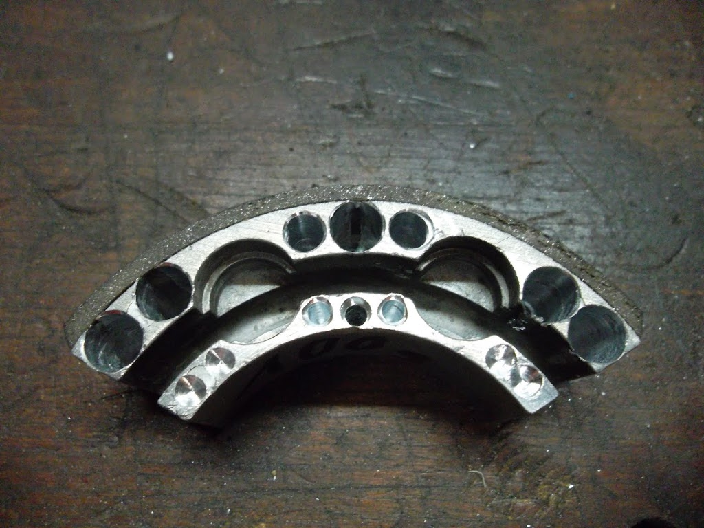

                            soderle, hab heut den Wandler zerlegt und einen Kupplungsblock mal bearbeitet. Mal sehen bei welcher Drehzahl ich lande, wenns zu leicht geworden ist kann man die löcher einfach wieder auffüllen. ori Gewicht lag bei 138g, nachher 100g pro Block
                            soderle, today got the converter clutch dismantled and processed one block times. Let’s see at what speed can I land, it is easy to become wenns fill the holes easily. ori weight was 138g, 100g per block after
