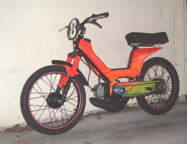

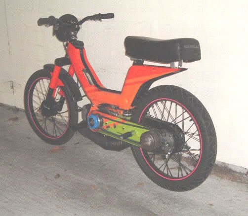

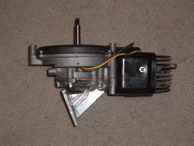

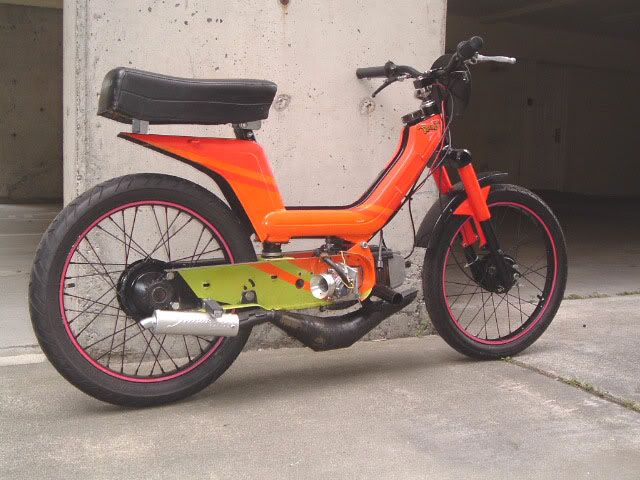

      I just wanted to share my racer project, called “Plan B” that I built for the Polini Cup races in Atwater, California. It’s definitely not finished, but built for now.
      Team Nerdspeed
      #147813
        Nice job on the side-inlet construction! Is that a kart-carb?
        Is the engine powerful enough to compete? Have you modified your ports?
        Thanks for sharing.

            looks very nice,
            you did a lot of trouble fitting that side-inlet
            with all the welding and cutting in the bridge!
            Did you reinforce your bridge after the cutting?
            I’m also curious about the performence?

              Nice Race-Si with the Malossi colours. I specifically like that your Si has a monoshock installed. Do they came with the moped at the time off import?
              And also what type of Polini cylindres are allowed in this Cup?

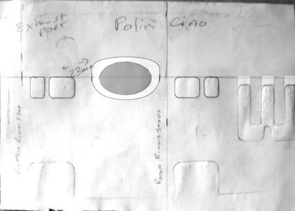

                Thanks for the comments! The bike is a 1980 Vespa Si and it does have the stock monoshock that came with it. The custom intake was a lot of fun to put together, but installing it in the subframe required considerable cutting. A aluminum support strut has been installed to provide proper rigidity. I’m using a 63cc Polini Cylinder which has been ported and modified. Currently, the performance is very poor. The carburetor -a Tillotson HL360- is designed for 80-100cc Karts and needs to be adjusted for jetting and proper fuel pumping. Additionally, I’m using 17″ wheels along with the Malossi overdrive gear set, so the bike has very bad acceleration. The Polini Cup class I race has an ‘open’ qualification, so you can run any cylinder under 90cc’s on any moped, provided it originally had pedals and no manual shift. Currently, Honda Hobbit/Caminos and Derbis are the fastest machines, but the Vespas aren’t far behind. I have until April to get Plan B up to race speed. Here is the current port map:

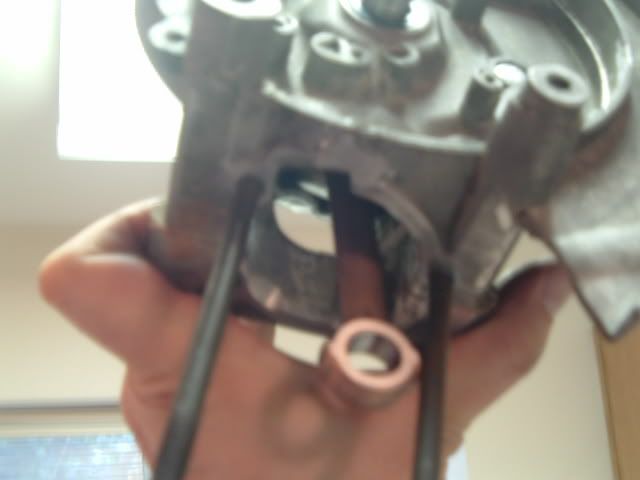

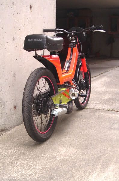

                              Just a further update…. During the last year, I built (with some friends help of course) a custom subframe for this bike. Then My friends went absolutely nuts creating a custom exhaust pipe.
                              #147919
                                Cool stuff. I would use a heatshield!
                                How does the pipe perform?
