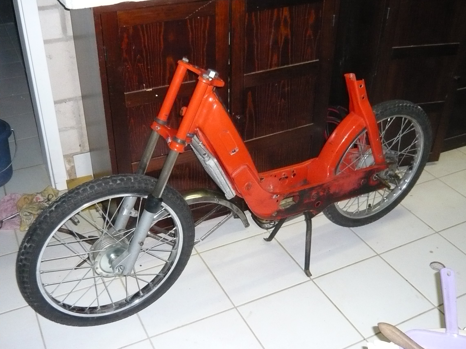

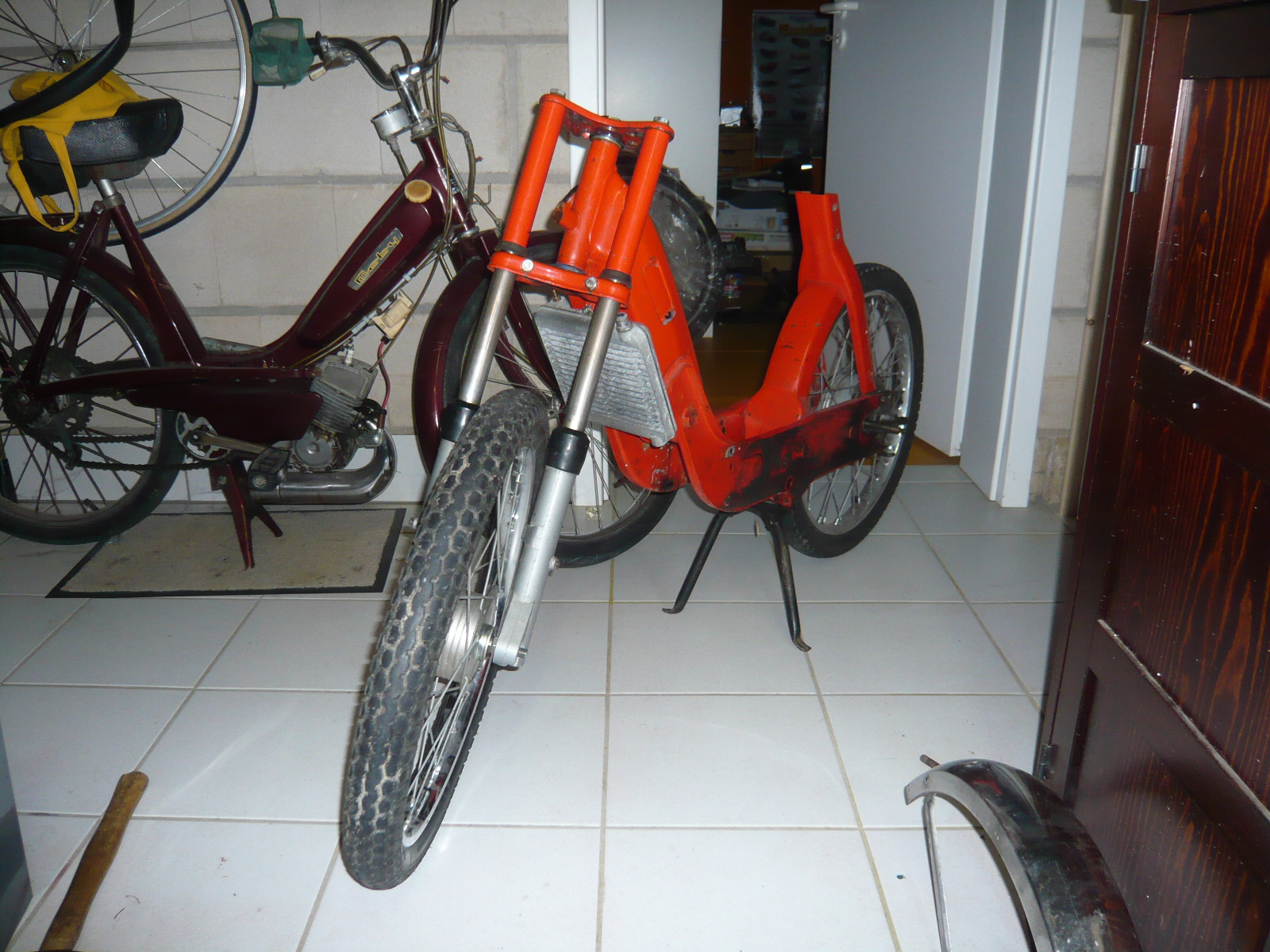

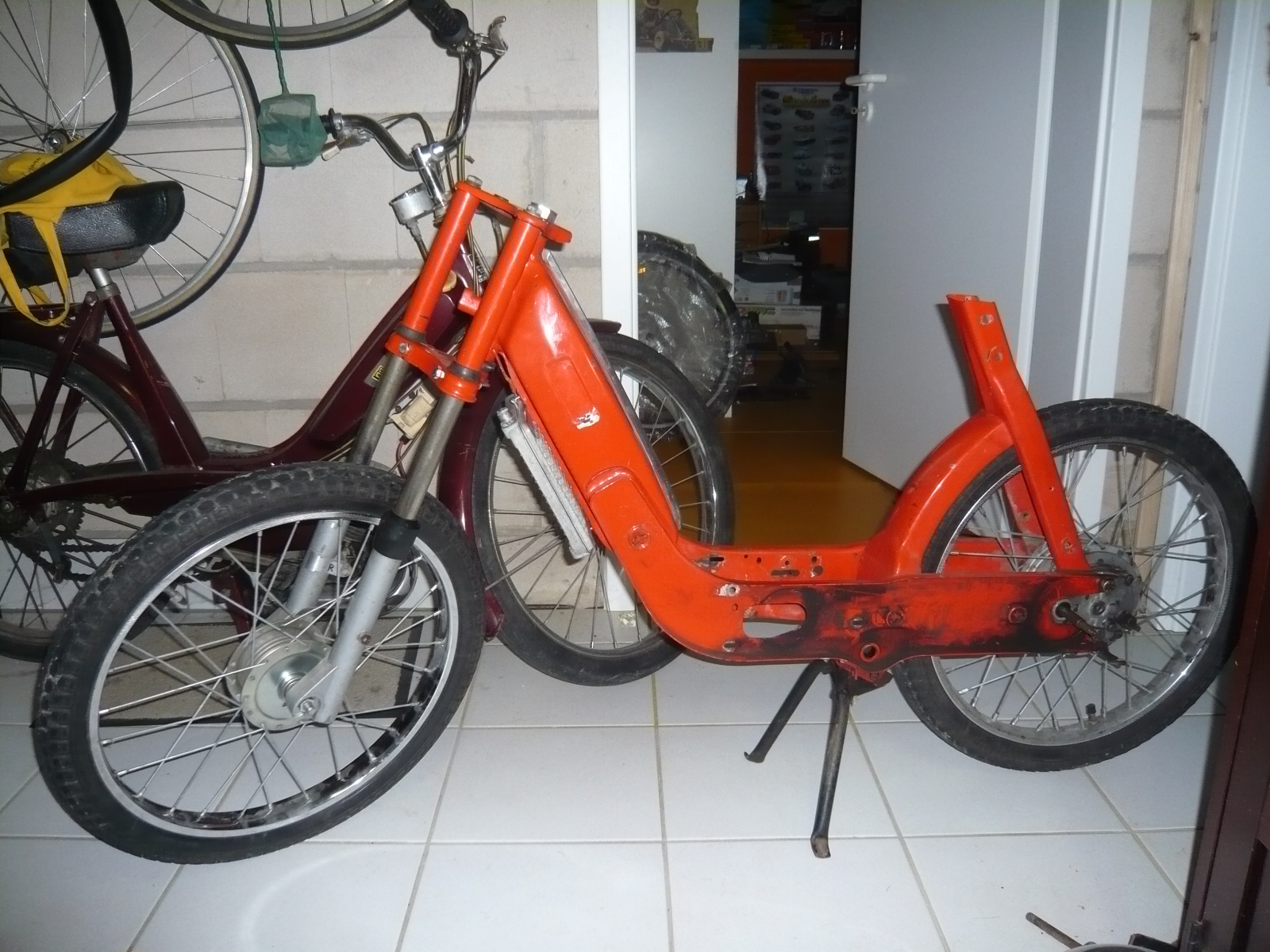

            Today I reworked the Si legs. Milled 9mm on each inner side as the hole distance for the legs in the Bravo fork bridge is about 18mm smaller than the Si bridge.
            Then fixed everything together

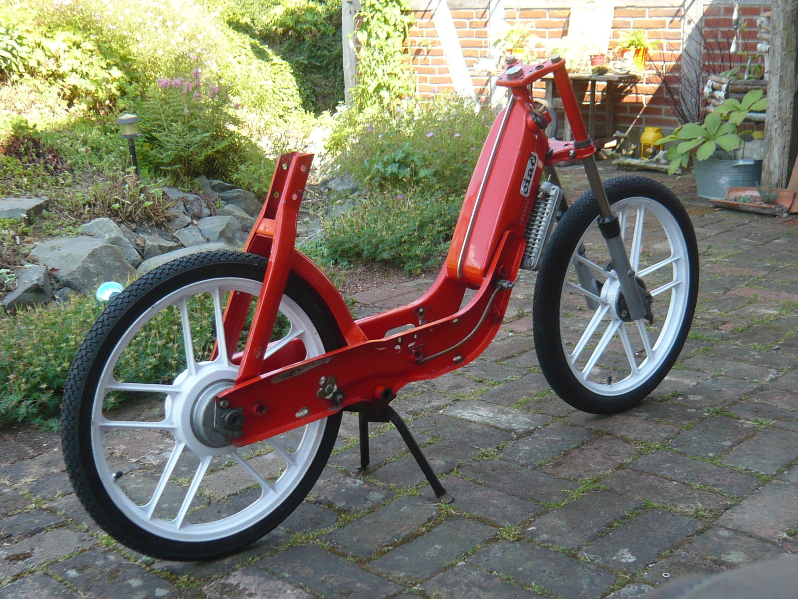

              got some nice 17″ wheels and changed them against the spoke wheels.
              I think it looks a little better now.

                Nice rims!
                Good change you made overthere. :thumb

                  This looks a whole lot better 8)

                      The new rims look fantastic!
