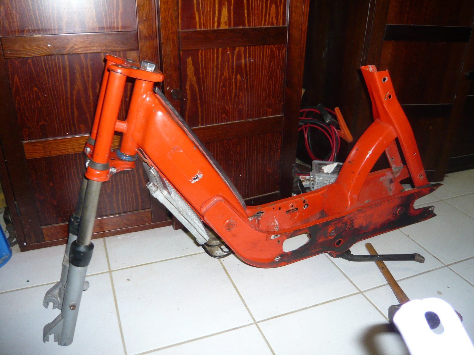

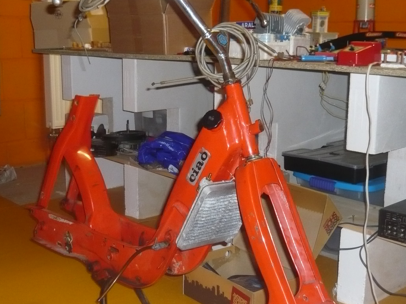

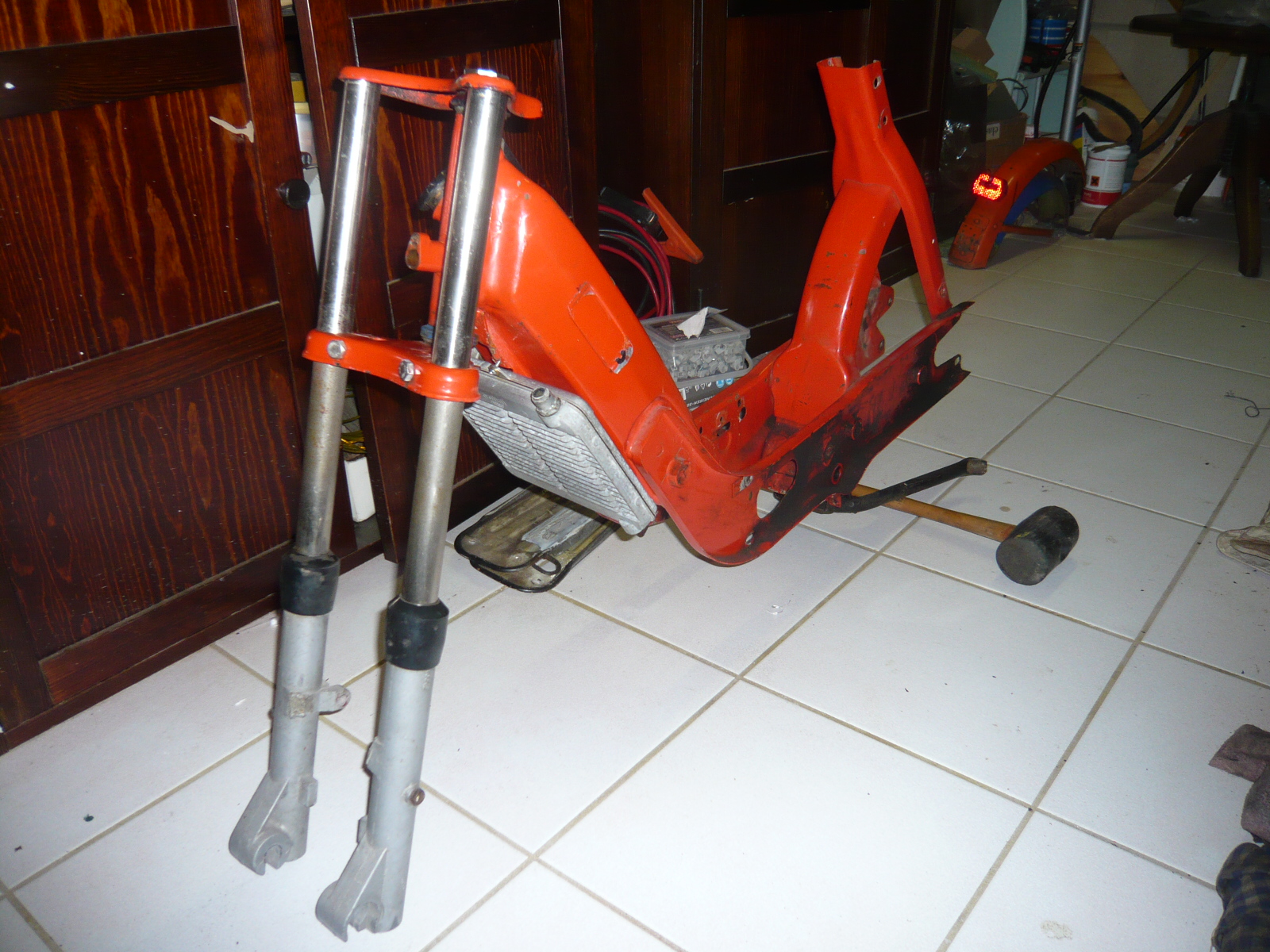

some time ago I got a nice Italian Ciao frame from Edjuh, thanks man:D
For a while I had not the right ideas how to rebuild this frame, but now a vision gets clearer 😉
See the first pics and plans.
Want to use the cool Polini water cooled LC Kit for that Project

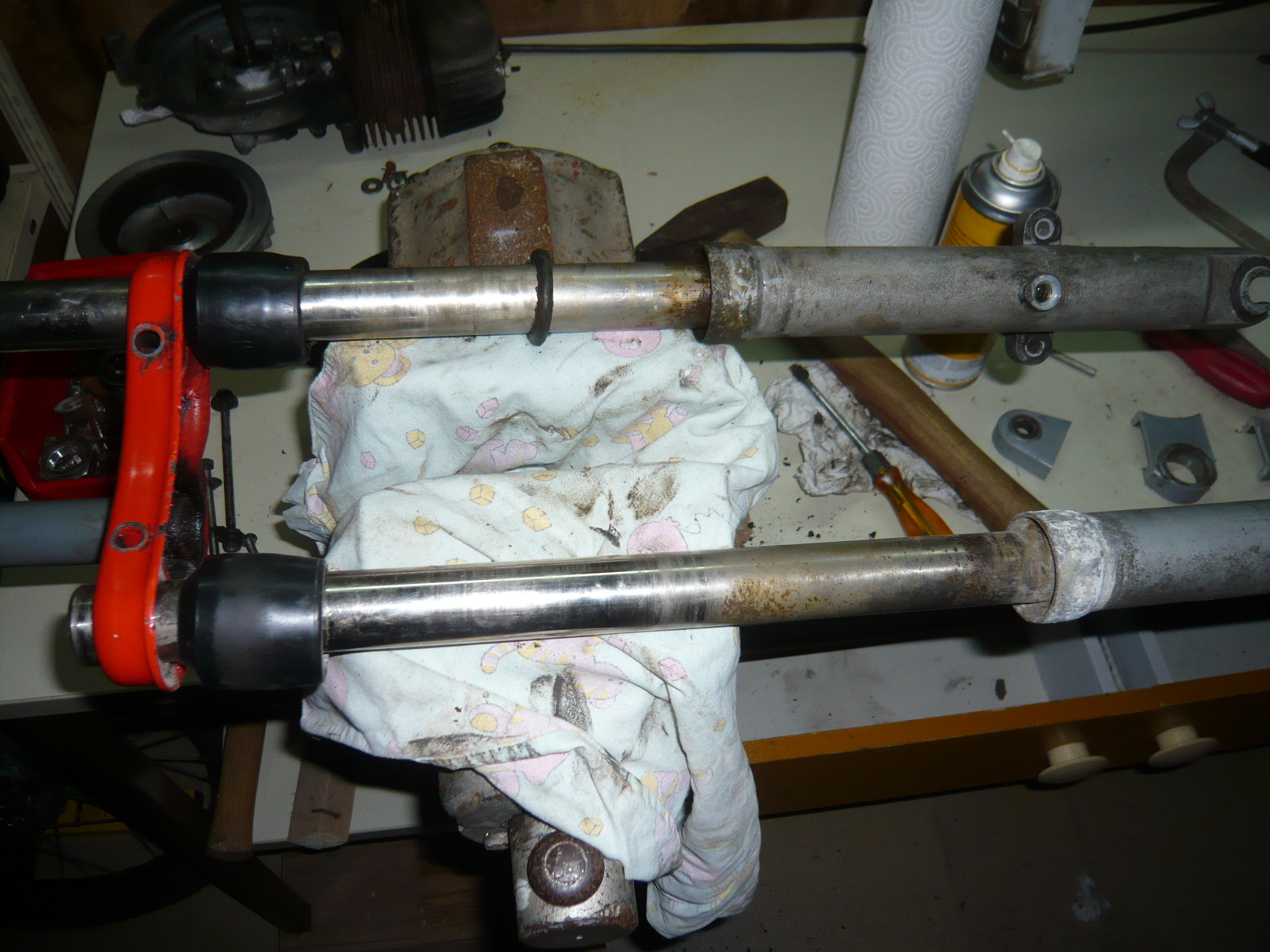

as the Ciao fork is 0815 style I like to assemble a oil pressure fork from an old Bravo SC. But unfortunately the pins of the fork were totaly fixed in the fork shoes. No chance to make them moving.:boos
So I took the fork bridge from the Bravo and assembled the pins and shoes from a Si fork;)
and as I like to keep the original Italien color I fixed also the red pin covers from the Bravo. Funny, it looks that the frame and the fork have the same original red color=)

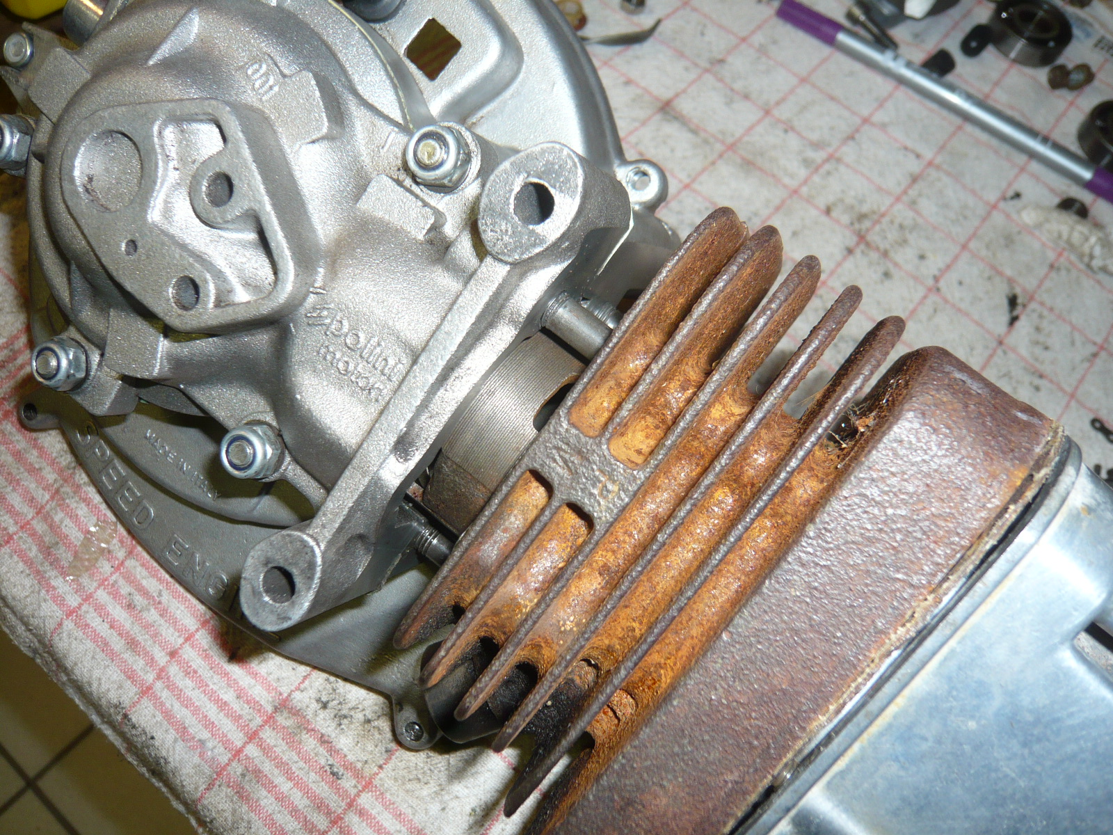

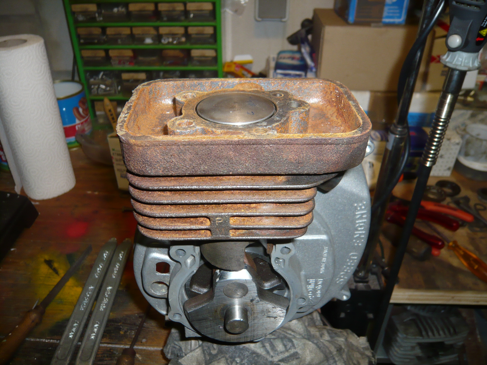

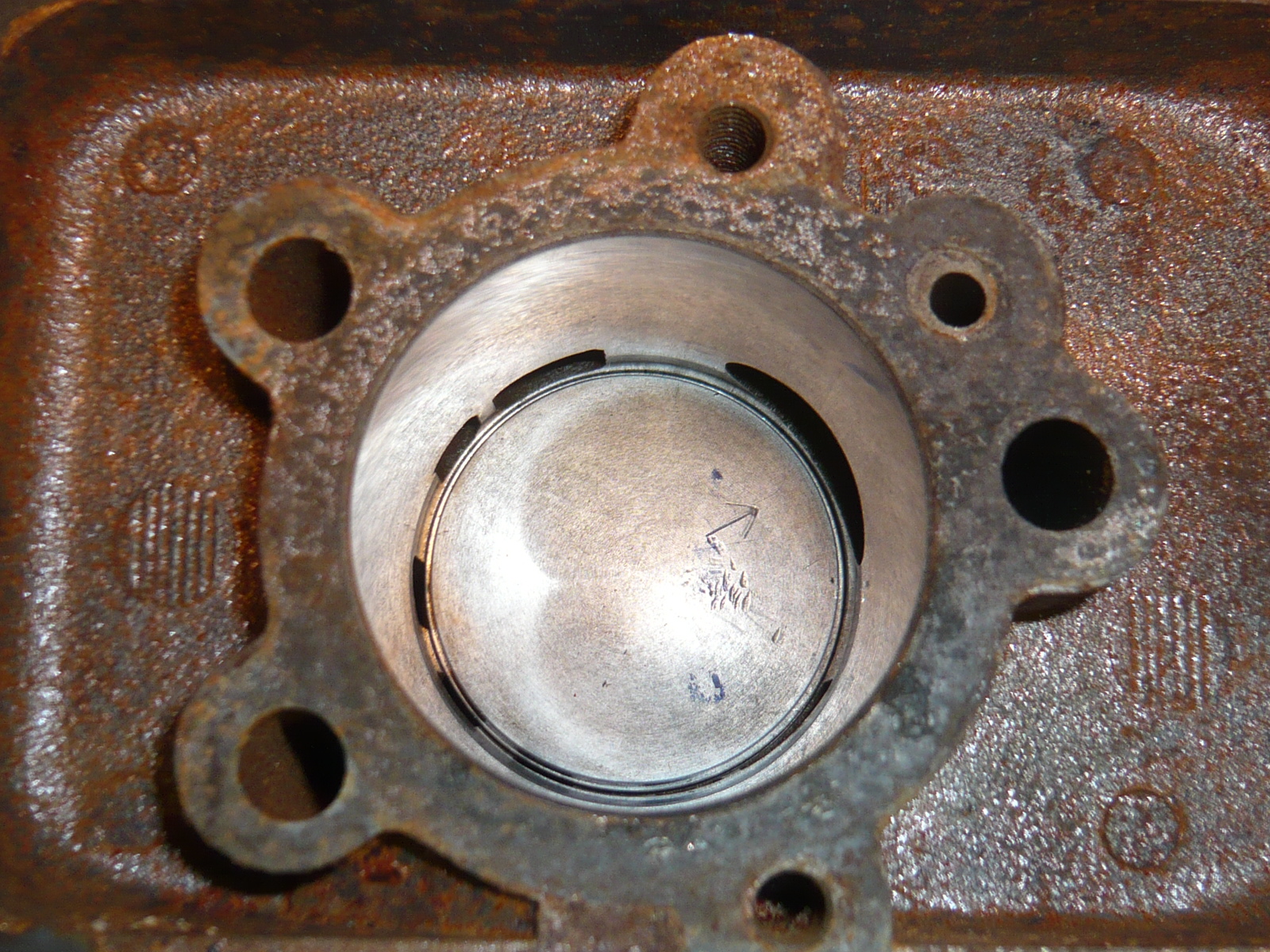

Do you still have the original red bagage drager plate from that frame?=)13 februari 2010 om 16:56 #458114started with the engine today
adjusted the foot gasket to the cylinder and carters
deck hight without head gasket is near zero:D
all ports are nice open at UT
after krukas timing calculation the inlet should open at about 131° before OT and should be closed at 64° after OT for a 195° total opening time.
The bad thing is, that the ori krukas opens the inlet at 137° befor OT. That are 6° earlier than calculated.:boos
If I would still use the calculated closing time of 64° I would get a total opening time of 201°.
Should I go for the 201° total opening time or should I use 58° after OT to get the 195° total opening time with the given 137° ?
