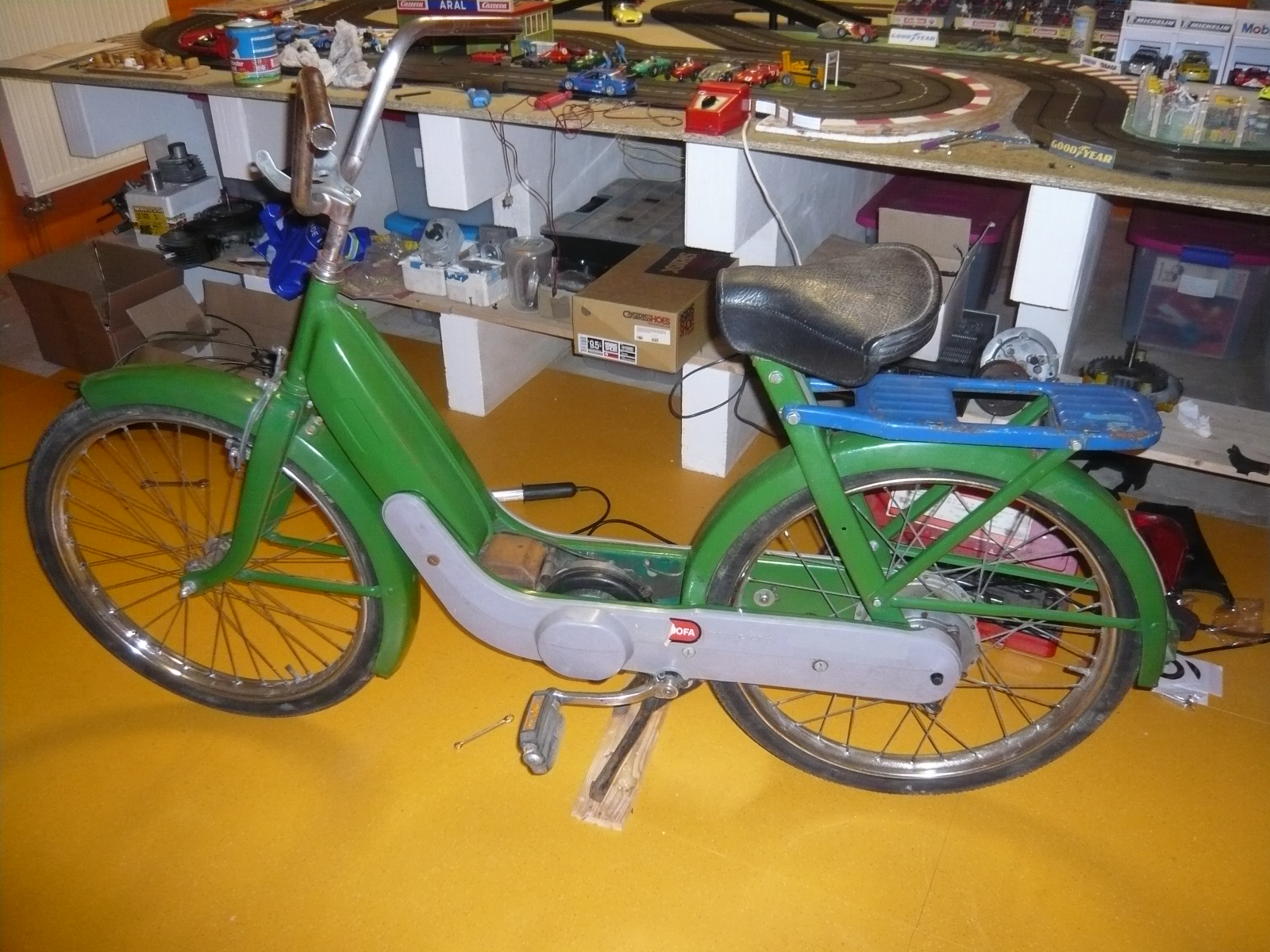

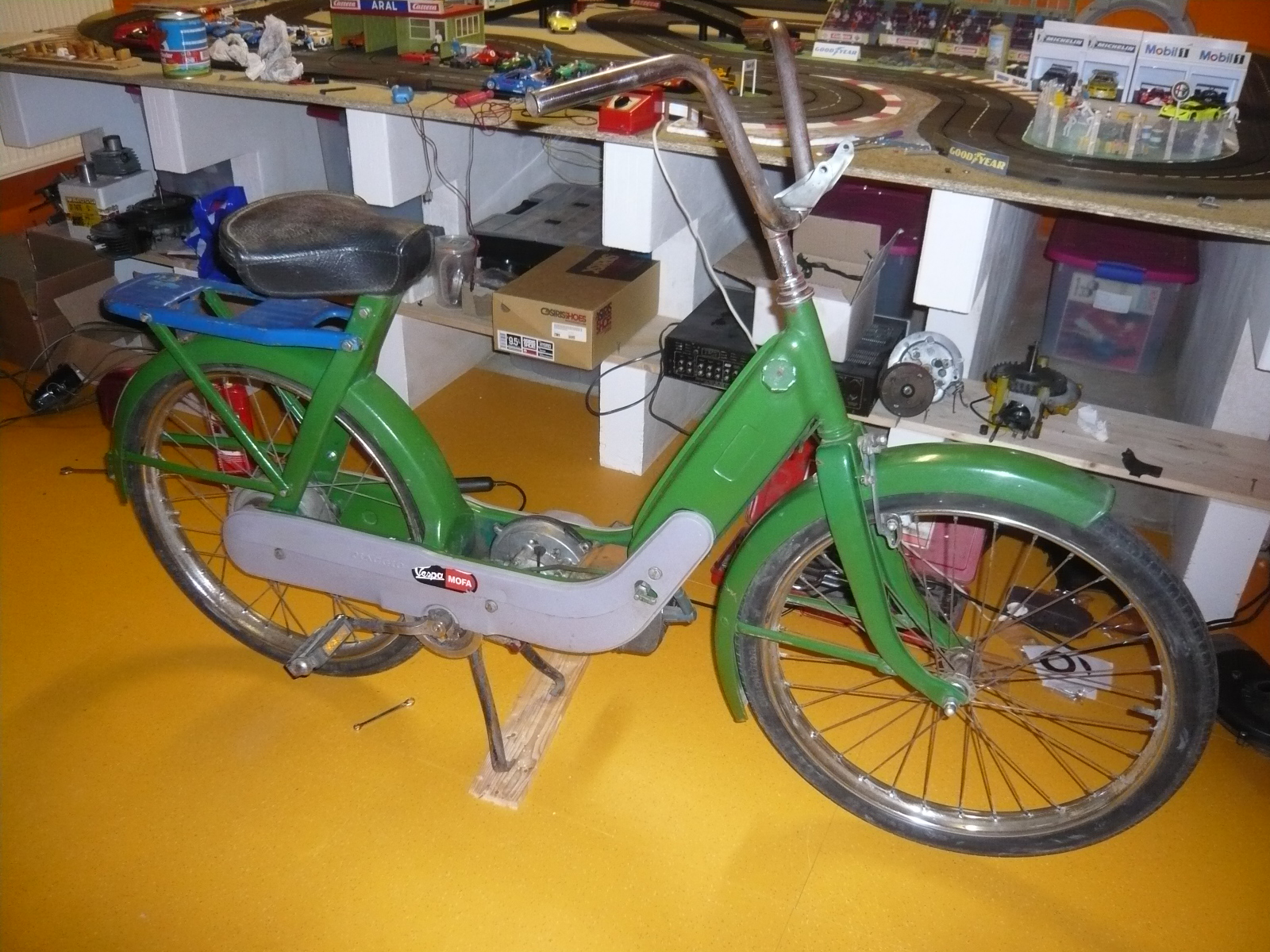

              as it is to much work to remove the multi layers of color I have cleaned everything and assembled again.
              As the bagagedrager has to much bumps I changed it with a blue one.
              and put the 1970er Moped engine in:D
              allways crazy the position of the eginition coil:)
              Tomorrow I will assemble the rest parts and then try to drive.
              I think it would be a good idea to powder coat everything in spring when it is warmer again.;)
              maybe that type of color

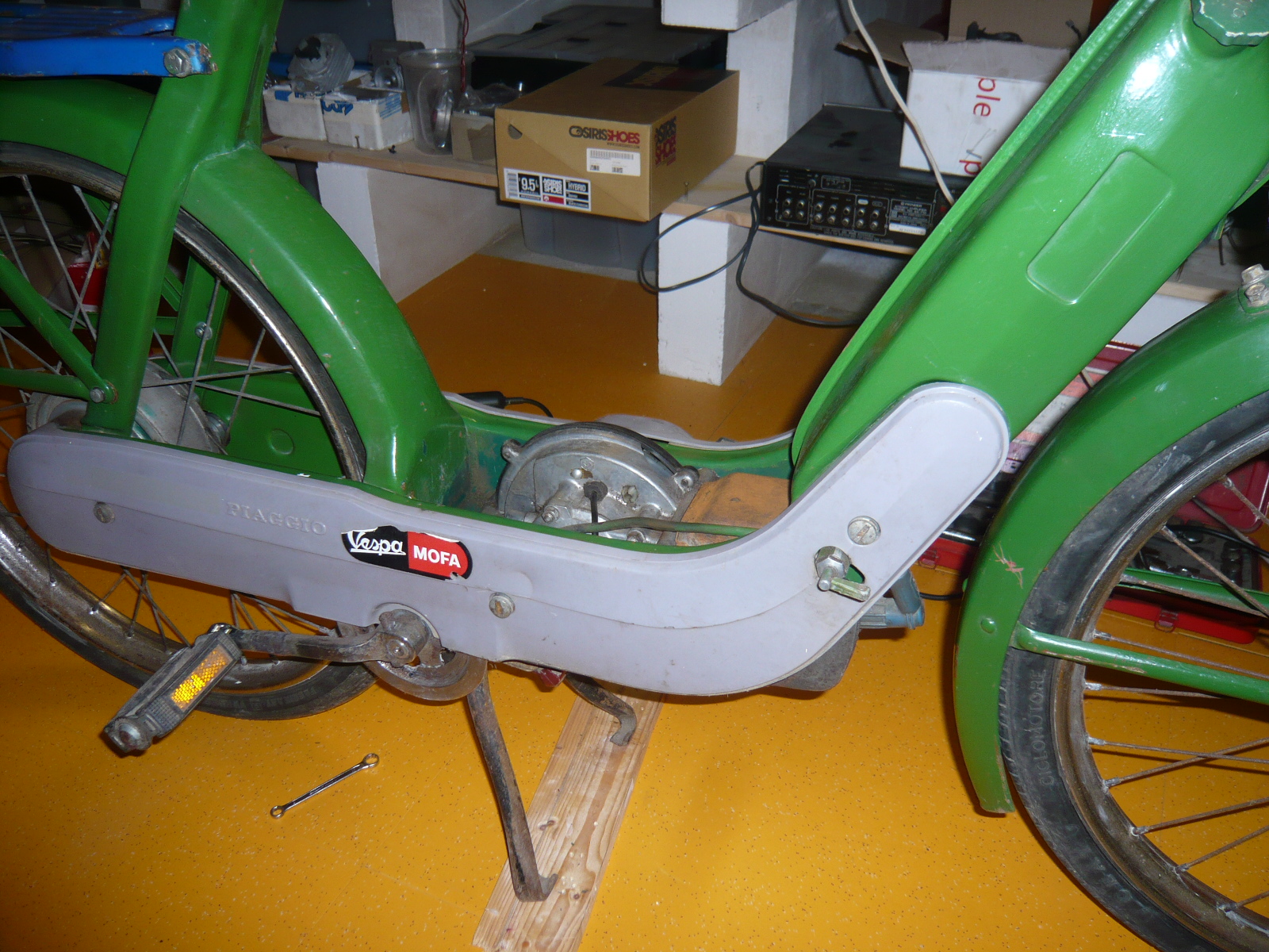

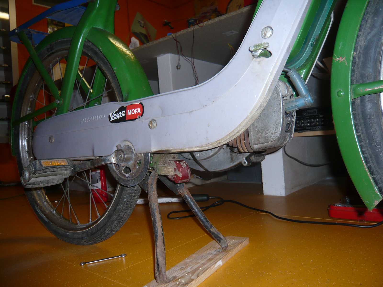

                    the old engine from 1970 didn’t have an egnition spark 😕
                    So I changed that engine with a newer model 50Km/h Moped engine.:D Also put my old Chromie from 1976 on. Then tried first start in my cellar…….it runs=)
                    Tomorrow I will have my first drive with that crazy vehicle. Arvid, the front brake is working very well. :lol

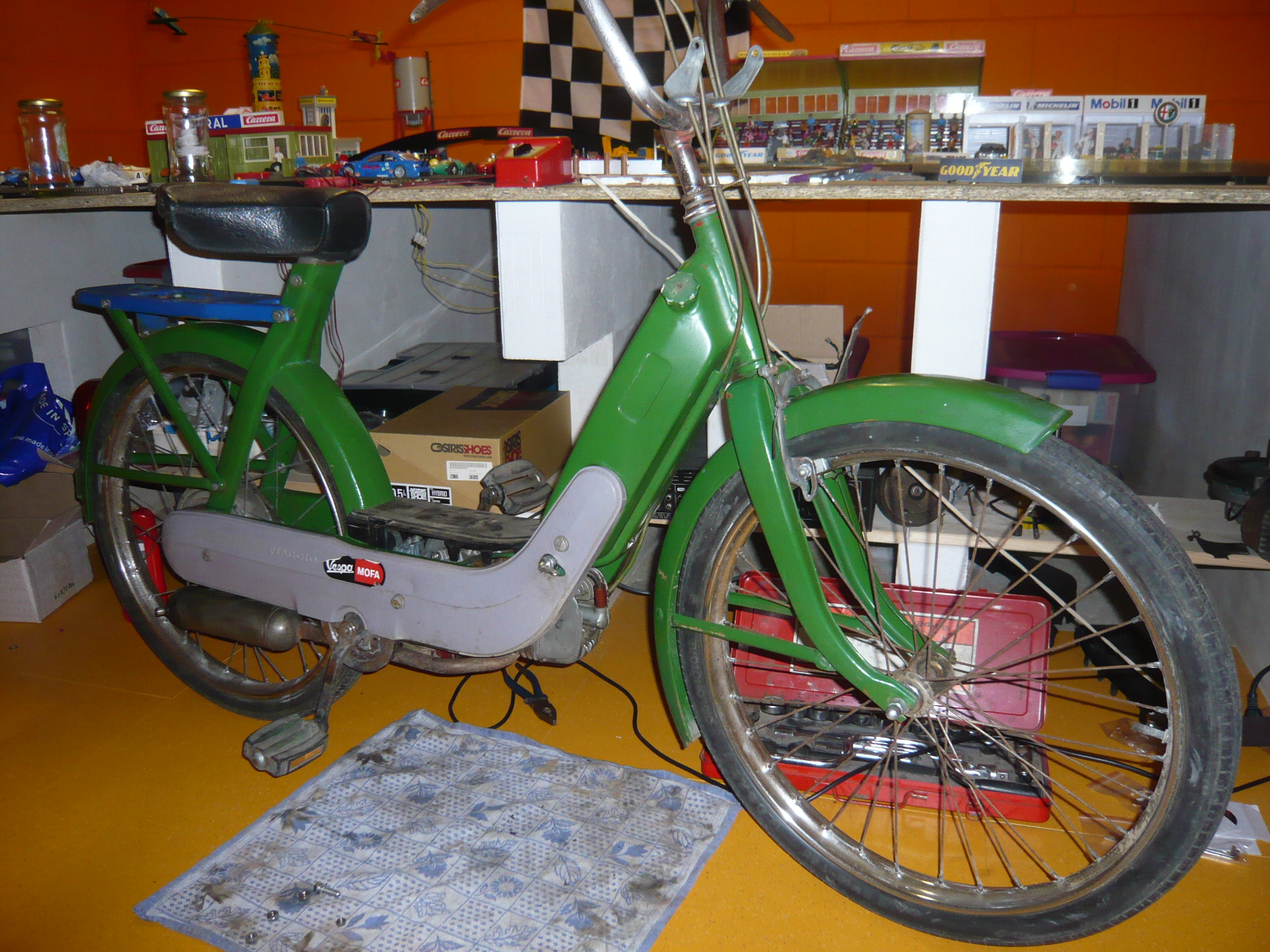

                      #276132
                        hey guys, just come back from my first ride with that crazy Ciao and I can’t get my smile out of my face=)
                        Really, after having driven that Ciao without any kind of spring suspension (only one in the saddle:D)I can not understand why Piaggio left that concept and started building that softegg Ciao’s with suspension in the fork and in addition in the saddle pin.:?
                        The behavior of that Ciao is fricking stiff and stable, no swimming on the road, purely great curve driving behavior:thumb
                        Very bad that we still have snow, so I only made a short tour.

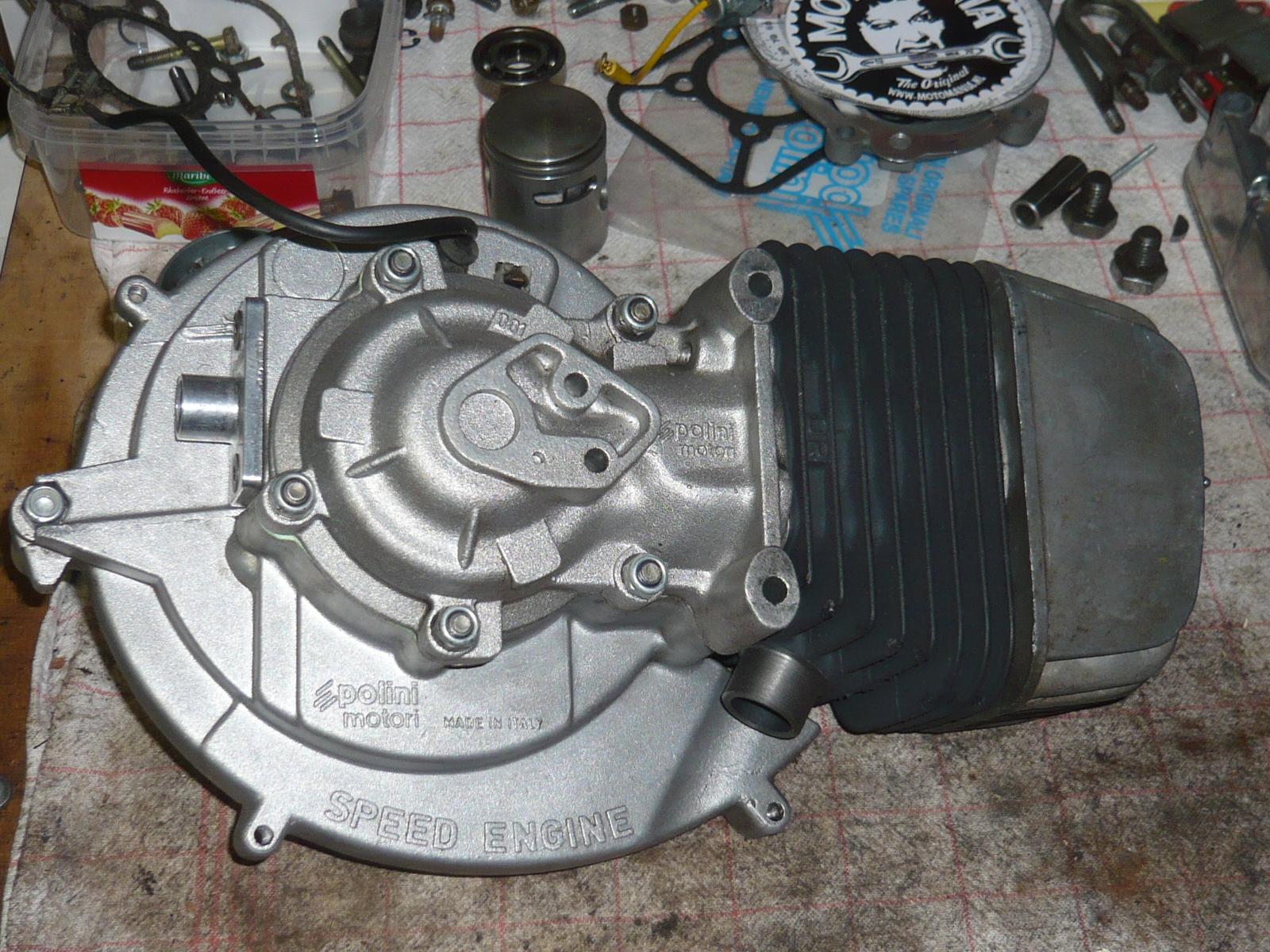

                              #277082

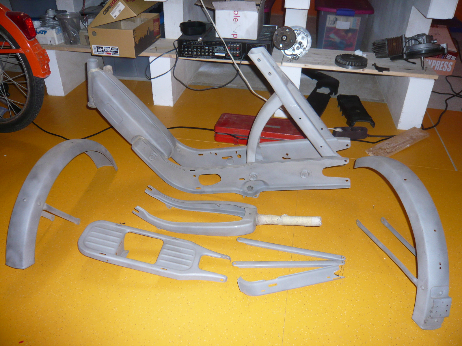

                                yesterday I got my frame back from sand blasting :relax
                                After eastern it will go for Powder coating in RAL 6021 Blass Grün
                                And a brand new 50ccm engine is wayting for the first ride.:rules
