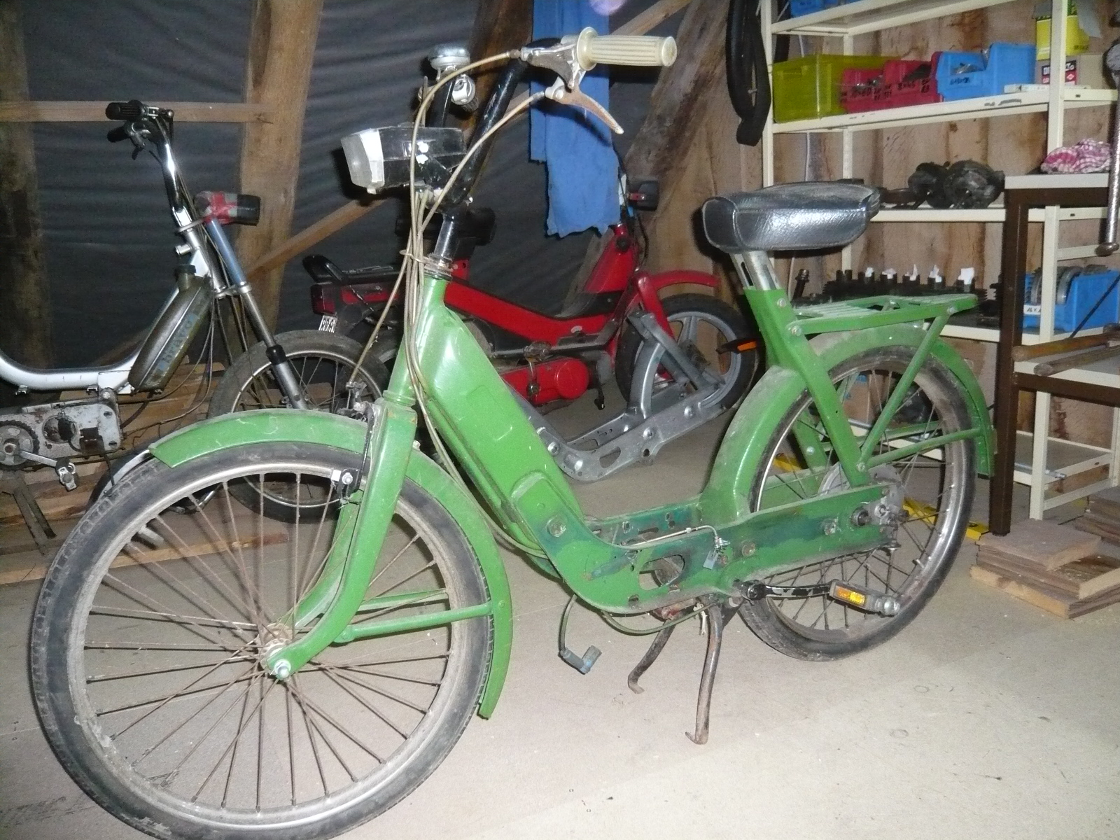

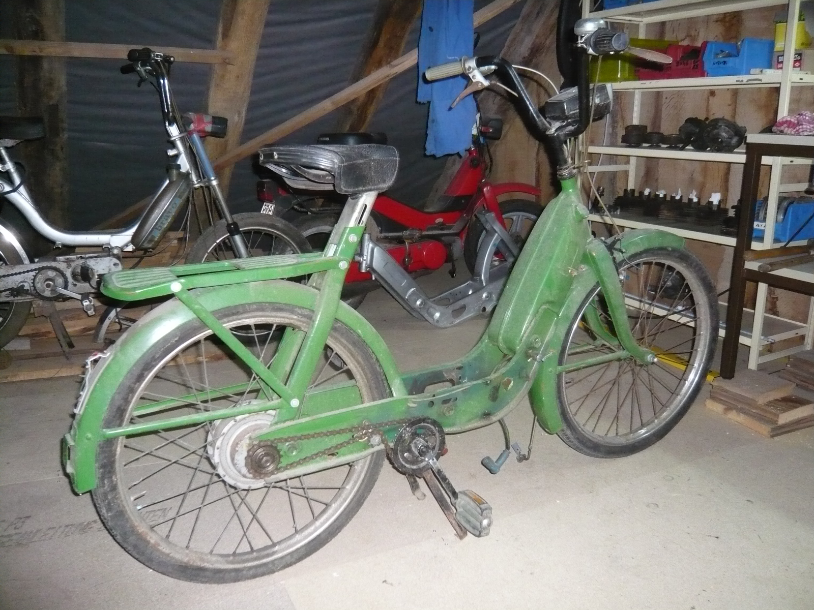

      jau, some weeks ago I got this old Ciao A without a spring fork.:D
      The wheels are 19″ and everything was complete. Only the engine was missing.
      The bad thing is that it is repainted by hand, that looks very ugly:boos
      Here some first pics

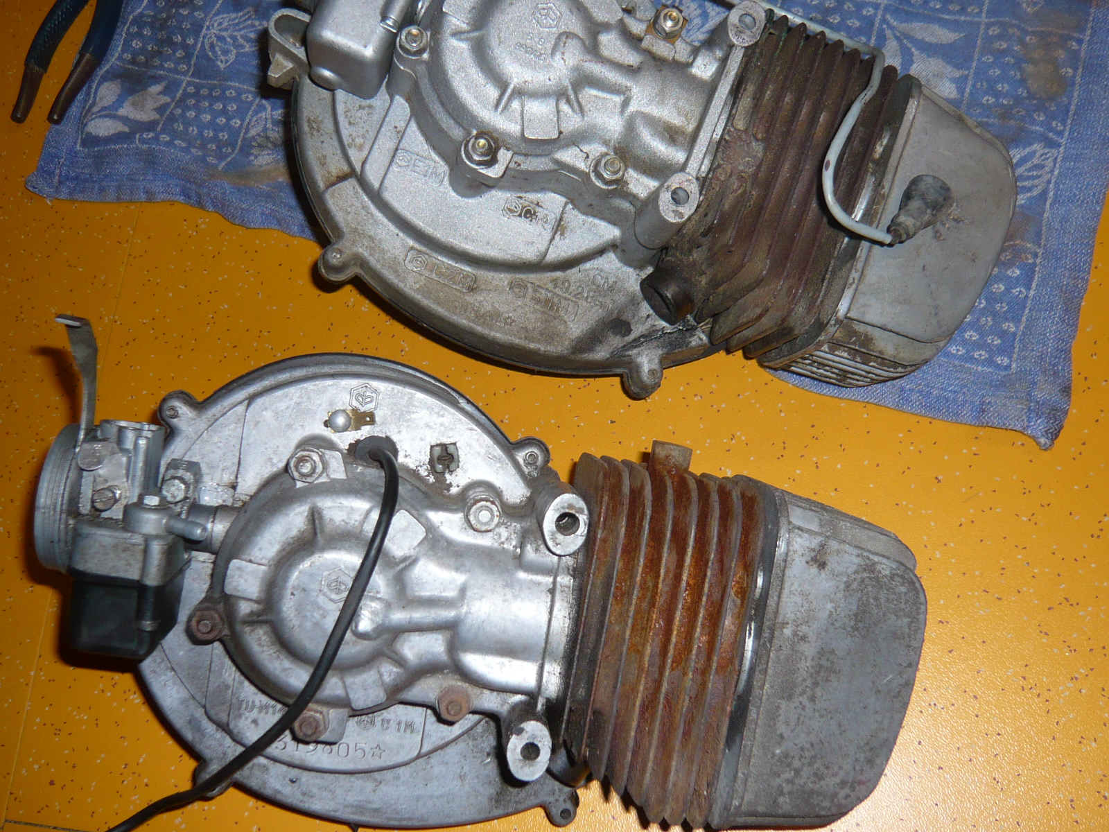

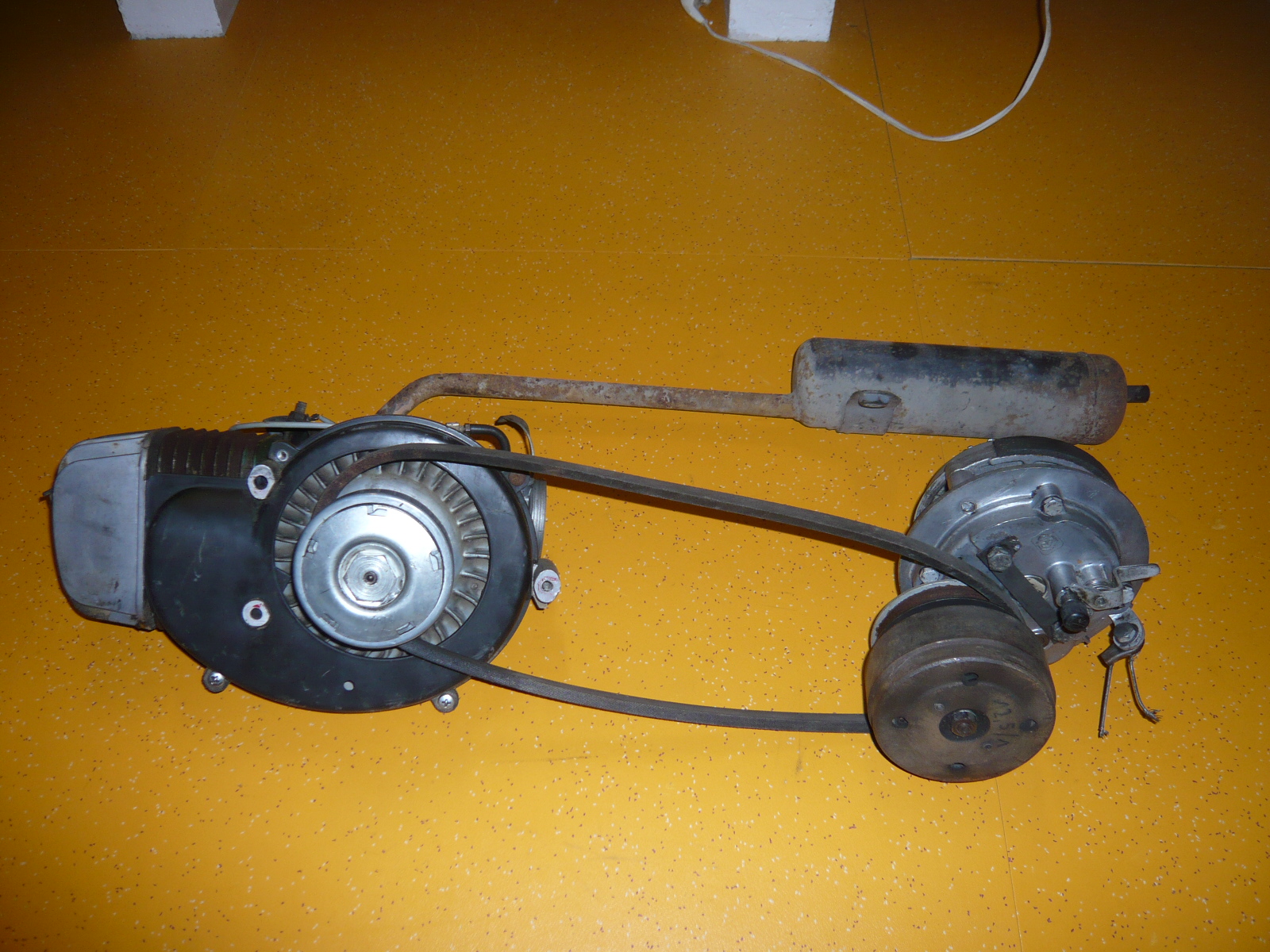

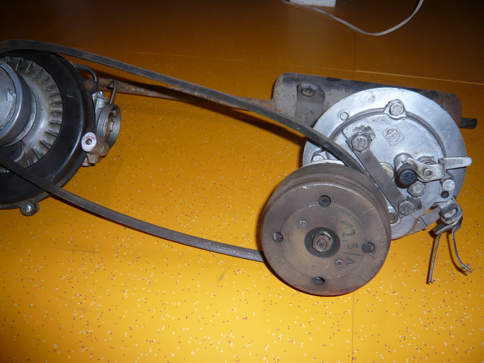

      I think that I already found the right old engine and a very old vario and vario gear box with 12,5:1 ratio.
      The gear box is the very old version for the 19″ wheels what has a different drive shaft and M8 fixing screws;)

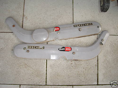

      Also found some old side covers

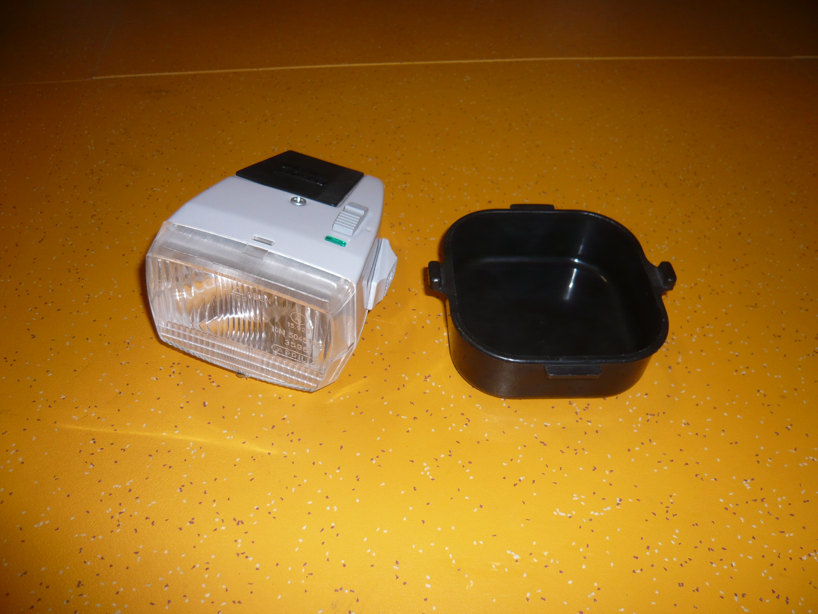

      and a brand new head lamp and tool box=)

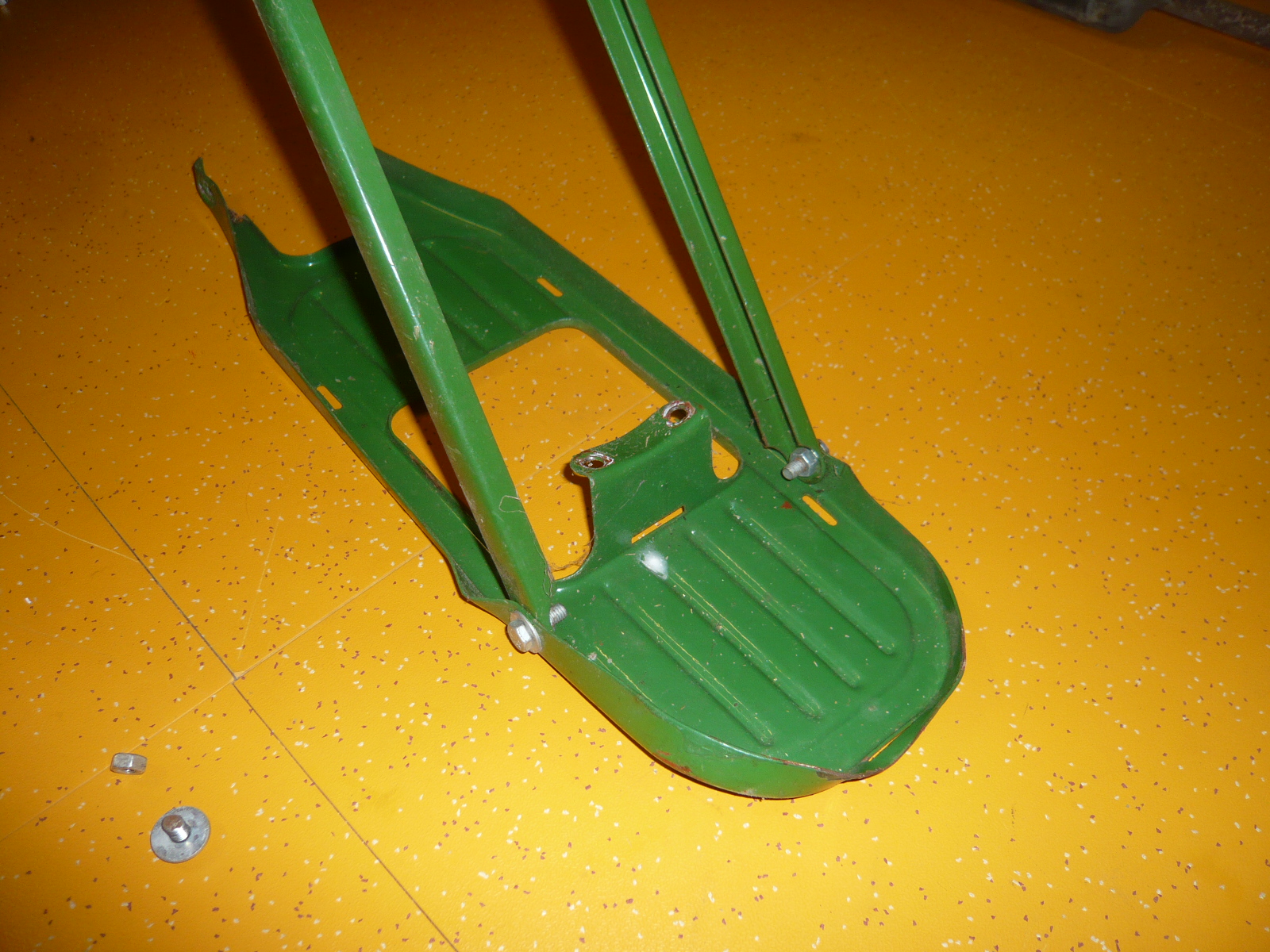

      Today I started to disassemble the bike and saw some not very nice bumps in the rear fender and baggagedrager
      Now I try to remove the hand painted color to get the original color back. First try on the backside of the baggagedrager

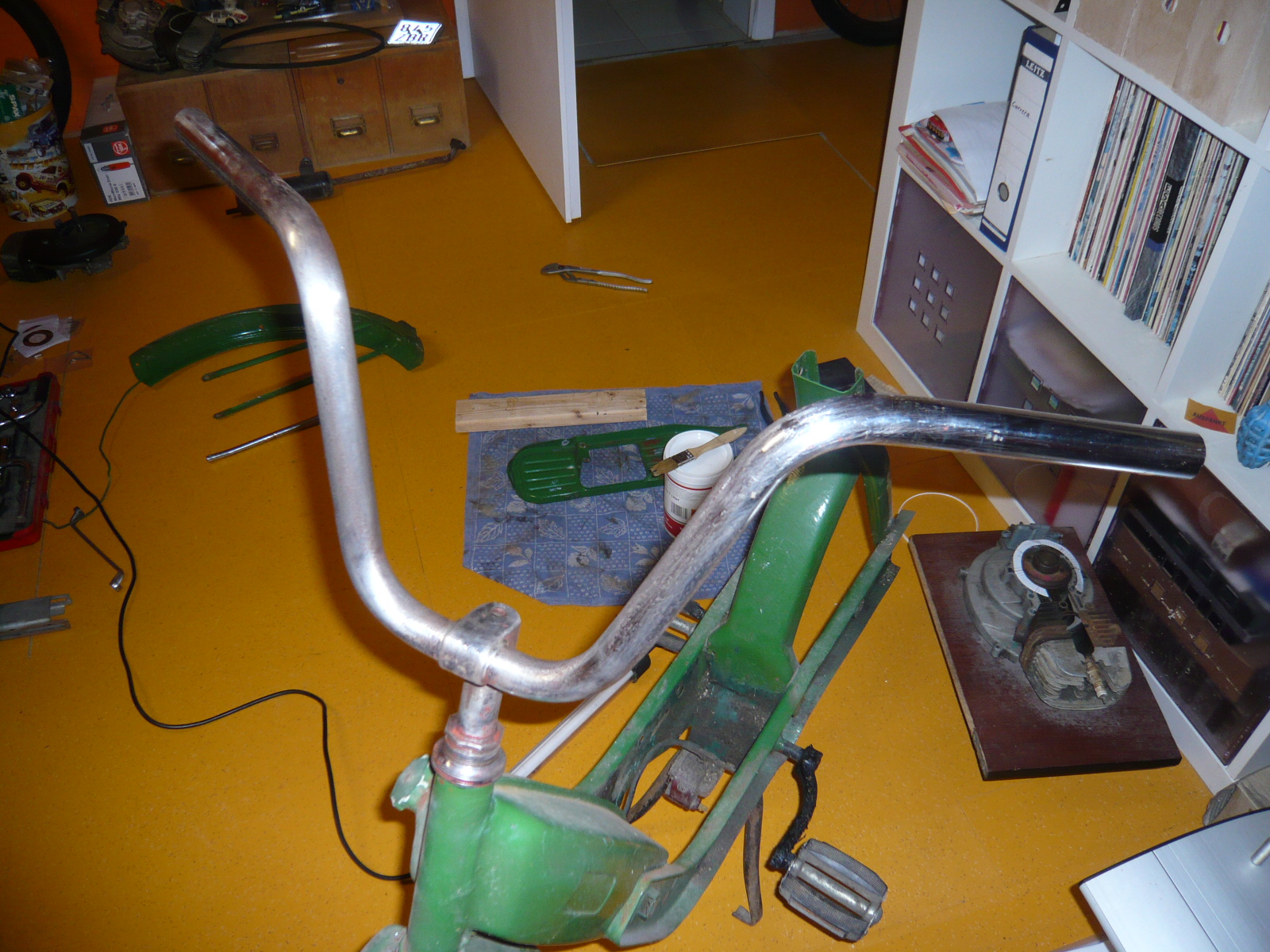

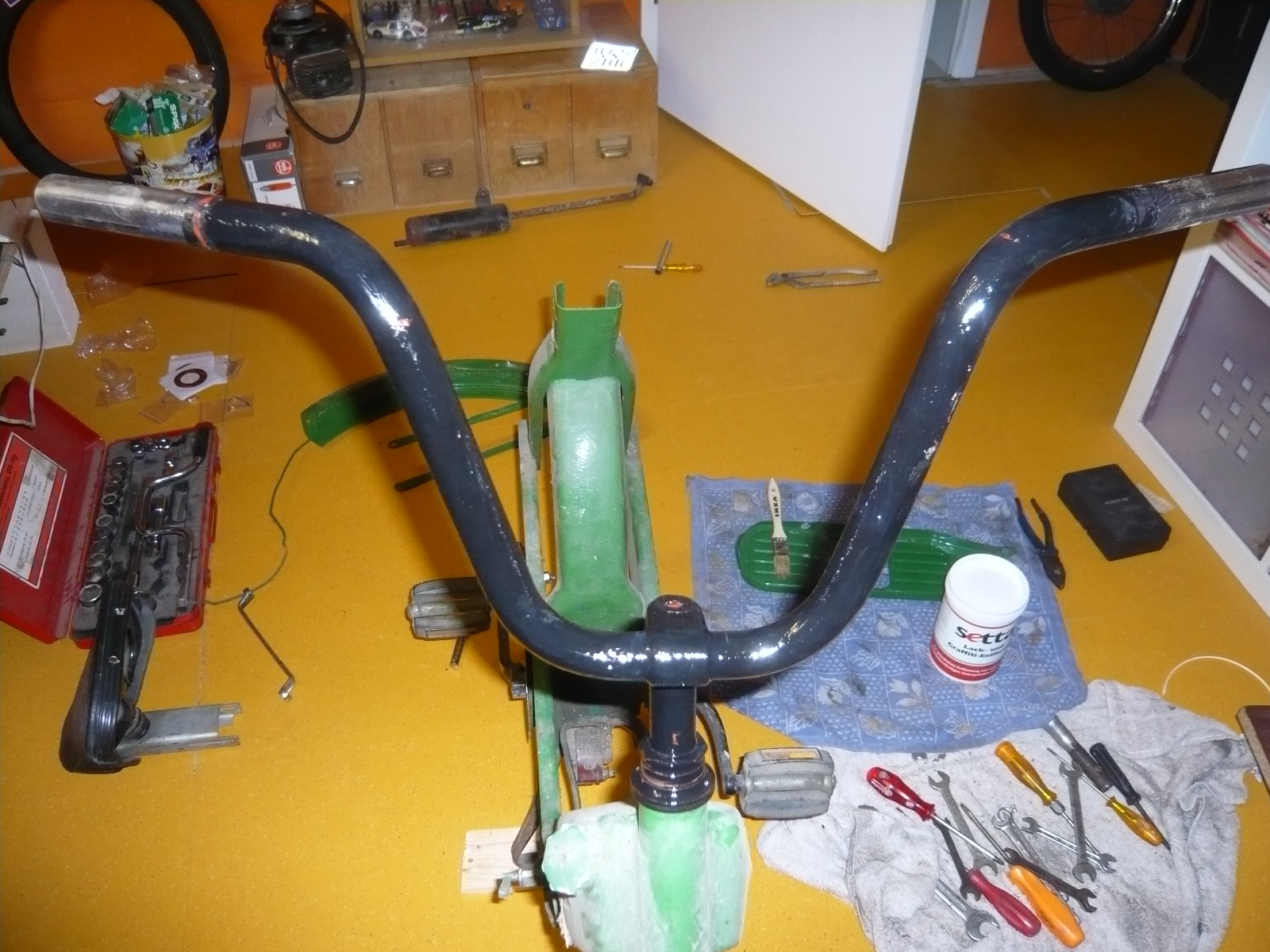

      and the black painted handlebar

        Too bad you don’t have variomatic side covers…
        The variomatic is the right model for your oldtimer. That engine might be okay, but the cylinder isn’t 60’s material.
        Perhaps the cylinder has been changed, or the engine just isn’t old enough for your ride.
        This is what a real oldtimer cylinder should look like:
        Solid mount for the cover: http://www.mijnalbum.nl/Foto-UQ8JEACO.jpg
        Studs visible: http://www.mijnalbum.nl/Foto-P6C7FOSH.jpg

            FonS, you are right. I will just go and check;)
            #275996
              Here are more pictures of my 19 inch Ciao’s engine: http://www.mijnalbum.nl/Album=NMGHXVG8

                so, just checked the engine and it is a newer model Moped engine with 11,5mm inlet.
                The minus clamp is screwed with one of the blok screws and the Aluminium casting has a rough structure.
                But I found a right version one in my fundus:D
                This engine is also a Moped engine and has the minus clip riveted to the blok. Also the Aluminium structure is not rough like on the new model one.

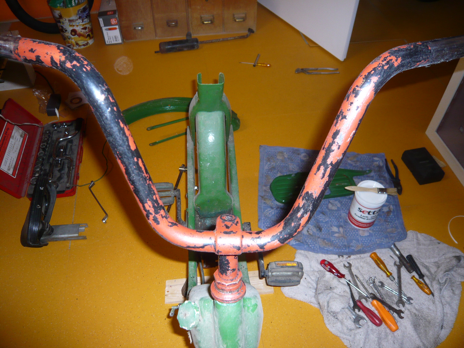

                                  after I was lucky to eliminate the black color on the handlebar there was a red color under the black:boos
                                  Put more Grafitti remover on, and schwups it looks like real handlebar;)
                                  The chrome is a little corroded but better than painted I think.

                                  Loek, if possible I like to keep the original color below the hand painting. That’s why I try to remove the hand painted color with Grafitti remover. But after a try to remove the top color I can see a darker green color and a red color below. Now I do not know what the original color was. Red or dark green. If I can not keep and restore the ori color I have to paint it complete new. No idea what color I should take. But should be one of the original Vespa colors from that time periode.

                                  G-no, Dein Deutsch ist besser als meins. Aber der untere Motor ist der älteste den ich habe, der ist aus einer Ciao von 1970 mit 19″ Rädern. Was älteres habe ich leider nicht.
