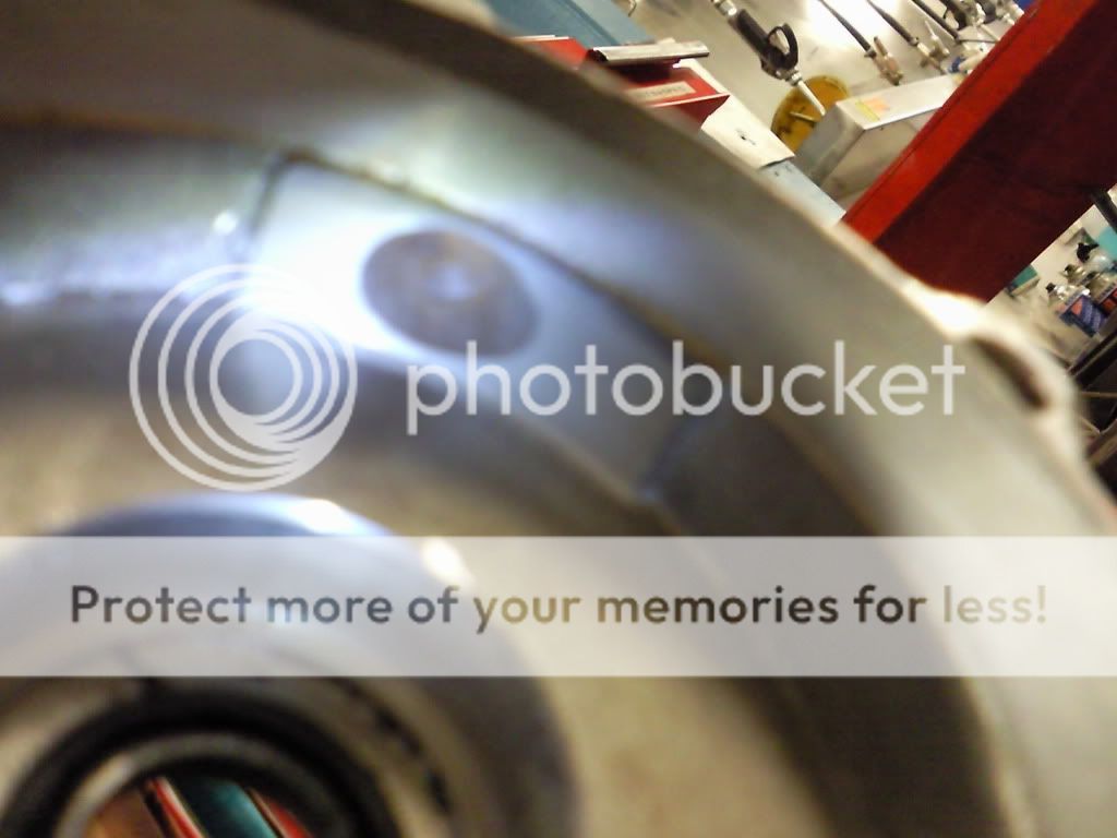

Will use original ciao wheel or 4-ekred from a superbravo. Will skip the deps then 😉here is some pictures on the bike btw;
overtuned engine…
