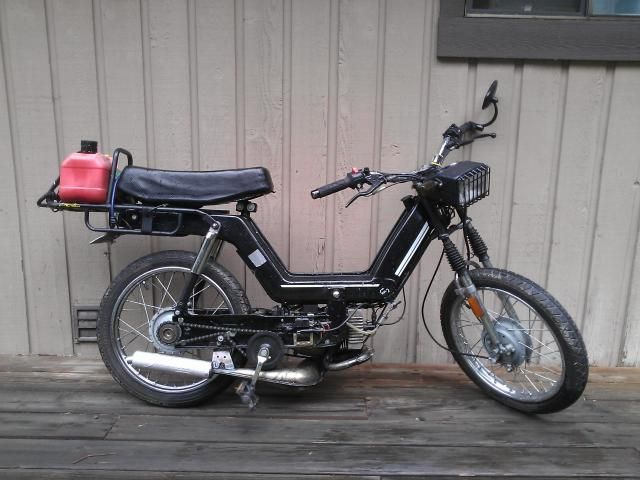

      Hi Guys, I am wondering about Your tuning experiences with this kit. What kind of RPM does it like, where should I expect the power band to be with a Simonini Proline? Any pipe that would pair with it better?
      I thought the Estoril I originally was using since before variating the bike was keeping the RPMs down, but I’m not getting much more out of the Proline, though it did want more jet (92!). Only leak is seeping at the exhaust clamp, hard to seal that up completely..anyway it’s good at WOT and the plug looks just right.

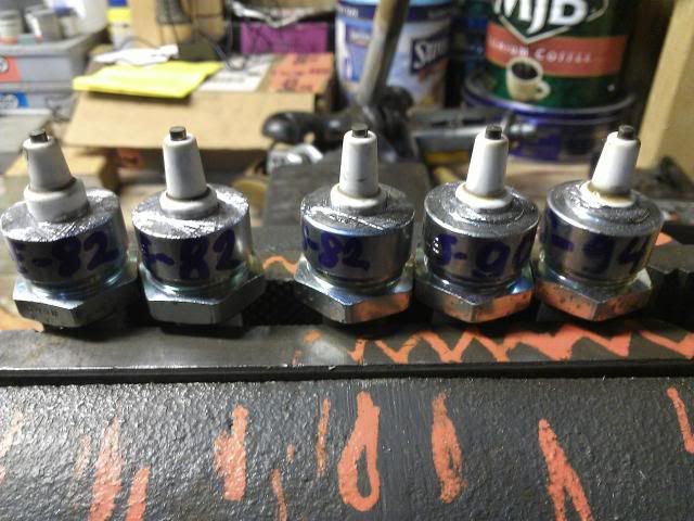

          Meanwhile I decided that since I had to re-build another transmission I’d try taller gears and maybe get to 80km/h+. When I finally got the bike back together with new clutch, trans, and gears, I cracked my variator on something (still don’t know when/what, having too much fun) which bent the crank, which promptly snapped. So, over the winter I ported the cases close to the maximum, transfers and boosts all the way down to the crank lobes, and used an anticipato crank. I tried the biggest jet I had first, an 82. It four-stroked at idle (time to shave the slide), but still seemed lean at WOT, plug chop confirmed. Hitting 75km/h and only 6-7k rpm max, and the vario is not tuned in and variating fully yet. This is according to a TinyTach which I’m starting to doubt.
          I figured 80s, but I got up to 98 just in case. I also finally got the proline so I installed that.
          I tried the 80 first, lost power and top speed, felt lean but i did a chop anyway and it confirmed it, 90 was better and faster, but still looked lean. 98 felt rich, four stroking up most of the throttle, but would clear out at WOT. 94 was fastest so afar so I chopped and it looked a bit rich, so I went with the 92 and essentially got back to where I was with the estoril.

                    I broke the sub-frame on my bike, while the engine was out to install the re-inforced replacement I changed the seal. It did seem to help, as I downjetted from 88 to 84 and my head temps stayed around 350F/175C. I also put a notch in the slide to lean the idle to a reasonable mix and dropped the rollers down to 4.7gr. Did half the rally this way and all looked good so I went down to an 82. It runs great, peaking around 400F/205C and approaching that magic 80km/h mark at a bit over 7k RPM. Still seems kind of low, so I’m thinking to try some lighter weighs and the 100mm rear pulleys, see how high of an rpm it will pull through and still variate fully. Hopefully the 9.5:1 final gearing is not too high.
