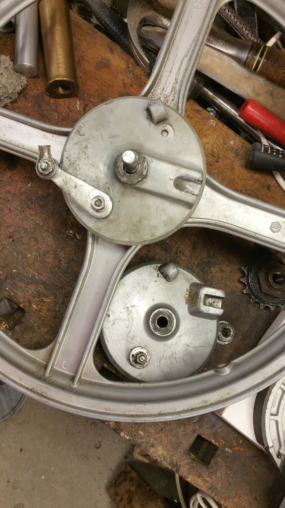

          Got the front brake kit from jeffreykruize today 😀
          Fits like a glove =) :thumb

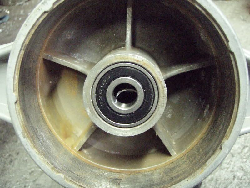

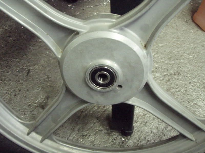

                I have found these pictures online.
                Is this something that you will recomend me to do?
                Can you buy the needed parts somewhere?
                #497342
                jeffreykruize
                Berichten: 311
                  I have both, the loose balls in the cup, and this bearing.
                  I don’t see a large difference both front wheels turn very long after a push when holding the front in the air.
                  #497343
                  Italjohn
                  Berichten: 138
                    Ok. Is it a straigth forward swap, or do I have to modify something?
                    And where did you bougth the tube that fit between the bearings?
                    Is this bearing ok to use?
                    #497344
                      You can buy everything you need here:
                      http://www.vespa-ciao.nl/forums.php?m=posts&q=36053
                      I use them myself and reccomend them :thumb
