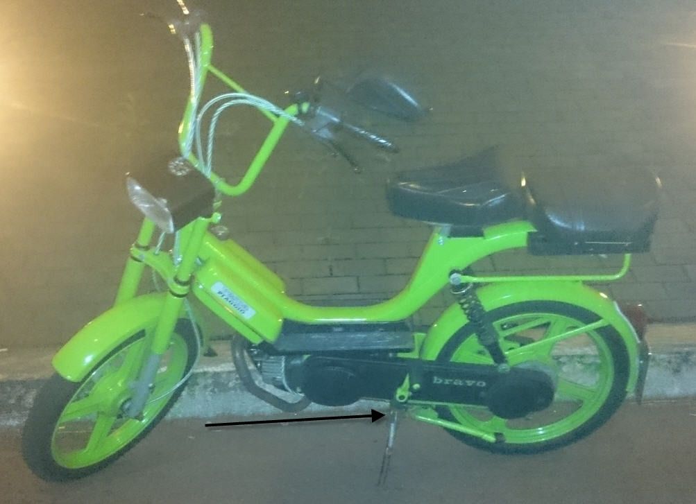

      At first, you are having a real nice bravo,
      I also have a 1984 bravo and an 1982 bravo..
      Made mine kawasaki green.

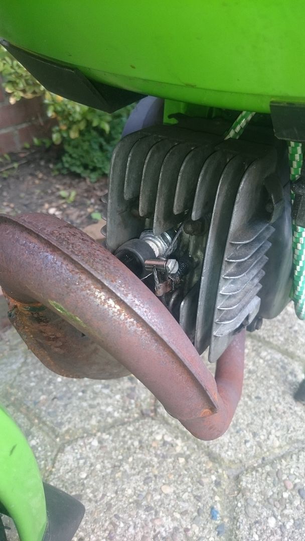

      Are you still interested in pictures of the decompression Valve?
      That citta stand fits a bravo pretty well, but can be a little to short if you’re using longer rear shocks.
      My bravo sometimes stands real dangerous on uneven surface.
      But with original shocks it works just fine.

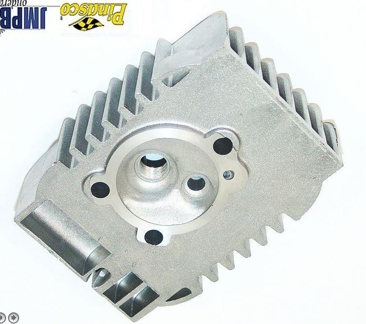

            Will this head fit my Polini 46 cylinder, without any modification?
            I don’t really like the Ciao head, and the decomp wont fit right on the Ciao head either.
            http://www.jmpbparts.com/cilinderkop-46mm-pinasco-citta-si.html
            Or is this head from Malossi better?
            http://www.jmpbparts.com/citta/engine-parts/cylinders/malossi-cilinderkop-47mm-citta-si-deps.html

              I would go for the Pinasco one. The Malossi one will require alot of work. You can already see one of the refinement issues of the Malossi head on the picture (The “holder” for your decompression cable.).
              #425432
                Yes, and in this picture te mallossie has no decompressie cannel.
                If you want a plug and play.
                I would certainly go for the pinasco head.
                But if you want to do some tuning adjusmets, take te mallossie.
                The decompression valve is smaller and this gives a better combustion chamber.
                If you flatten the head, you can make it exactly 46 mm.(And increase the compresion)
                There is often leakage between the decompresie channel and the combustion chamber. Now you can decide where you want to place the decompresie channel.

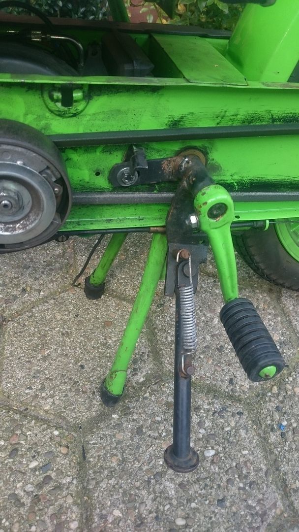

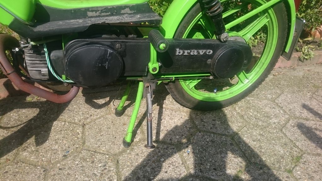

                          Anyone have a picture of how this sidestand are mounted behind the side cover?

                              how funny that you took my bravo to ask a pic for the side stand.
                              here are some pics i supposed to place like a week ago,
                              at first a pic taken from the front so see the angle the bravo stands in:
                              (take note that the rear shocks are 2cm longer than the orginal shocks, so the angle is a little less with the orginal shocks
                              a pic with side cover on:
                              without side cover, the stand has been broken before, so with the welding it has been placed in the same place again, there is no difference between an new and mine.
                              and then, an pic of the decompression valve, it was a hard pic to take because of the polini top one is messing with the sharpness of the picture…picked the best two pics

                                Excellent picture of the side stand 😀
                                The decomp is the wrong one, as I need to see pictures of the Ciao one.
