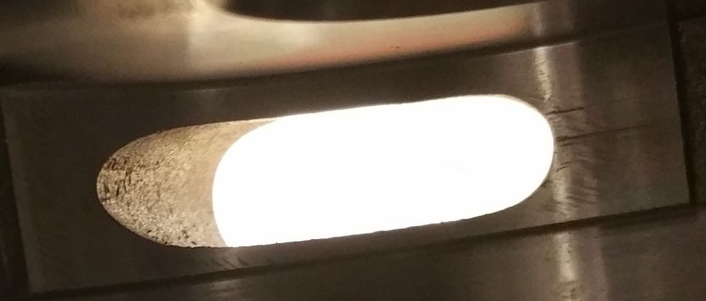

The Speed engine pacage was not sealed so it has been opened at JMPB. There is 3 bolts missing and there are some scratches on the inlet parts.
Edit: I see that on the pictures in the webshop, it’s supposed to be delivered with only 1 bolt, but I’m still not happy with it because of the scratches on the inlet.6 augustus 2015 om 20:29 #497016There are always 3 bolts missing 1 bolt is used for the mounting inside the frame wich is deliverd with it aswell (it is mounted at the moment). The screw is weird as fuck and like to see some detailed pic from other side aswell.
Also the scratches are weird but not going to give u that much of a problem they seem not deep at all and more like a bit of oil or something from the picture.

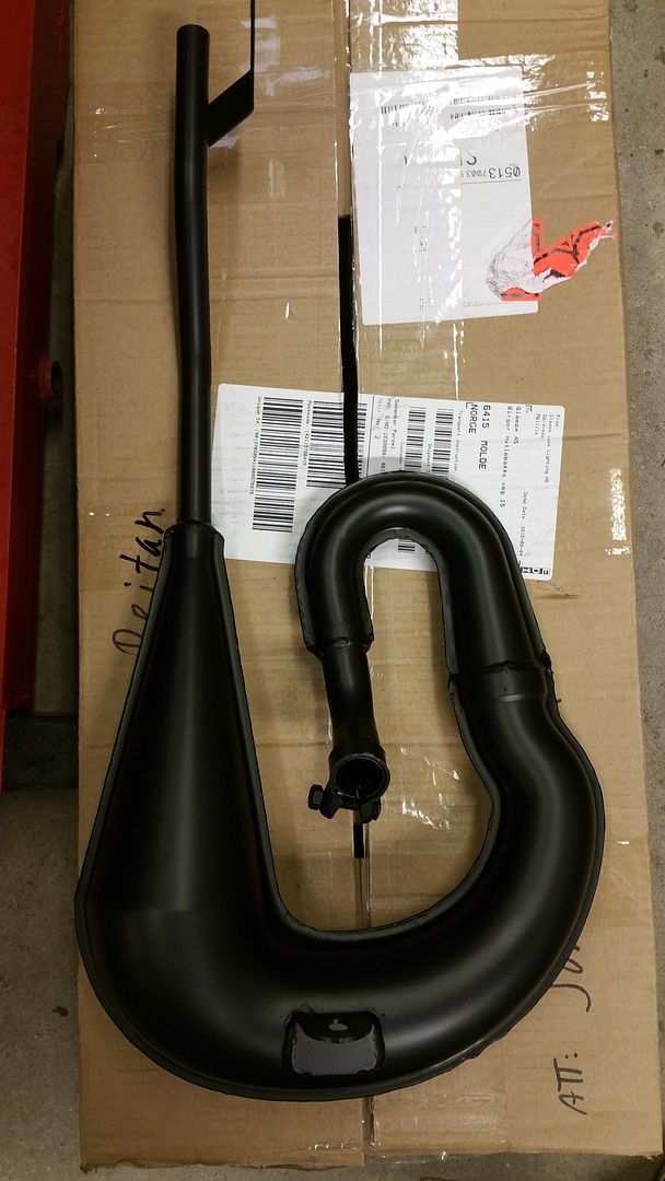

Is there some other brake solution I can use?And how do I screw the new exhaust to the cylinder??
Do I need some kind of spacer and a longer bolt??
There was no instuction manual with the exhaust.Did paint it with 650° laquer today as well 🙂

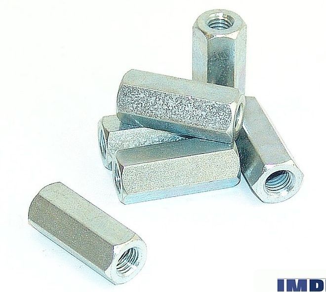

8 augustus 2015 om 21:18 #497029Found this picture on the forum 🙂
There must be some kind of extension nut on the lower stud bolt.
Can I order this missing part some where?

By the looks of it. It’s most likely you bought the good kind of brake pad. Once you took your rear hub, i think you will know how to change the pad. The exhaust is simply put down over your cylinder flange and then tightened with the 10 or 11mm nut. Don’t forget the other fixations to screw on your exhaust the right way.Edit: ooh and for mounting the exhaust the way on the last photo you need sometihing like this;
http://www.jmpbparts.com/vespa-ciao-si/engine-parts/exhausts/bout-uitlaat-vespa-m6-m7.html8 augustus 2015 om 21:37 #497032Excellent Martino, thanks 🙂

Are there different treads at each end?This is exactly right.
m7 for screwing this on your cylinderstud and the m6 for any bolt you want to use and fixate your exhaust with.8 augustus 2015 om 22:11 #497034You are a star Martino
