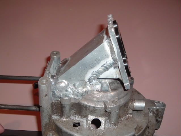

24 augustus 2009 om 18:56 #147695I’d say polini top one since you ‘sport’ the 43mm kit.
What’s up with that 25mm btw.? Did you redesign your barrel so drastically that it needs a big carb like that or was it a convenience choice? I’d go for 16 – 19mm. Do you have a custom inlet manifold? Malossi engine or side-inlet?
Any pics of your racer?

The reason for the big carbuetor (Tillotson HL360) is because ultimately I would like to build an even more aggressive engine, either out of a vespa or Honda Camino. TerryDean and I’s teammate has built a Camino engine with a LC Malossi MHR cylinder for a Aprilia Scooter rated around 18hp. The racing in California has heated up the ‘arms race’ in building fast mopeds for the hardcore guys out here. We will have bikes on par with the fast dutch guys probably within another year or two.
My blog: http://team-nerdspeed.blogspot.com details all the development, but here’s a pic or two:
Intake, under construction
Port Map
Exhaust – 186.30°
Mains – 128.6°
Boost – 131.4°Paint Job, under construction
