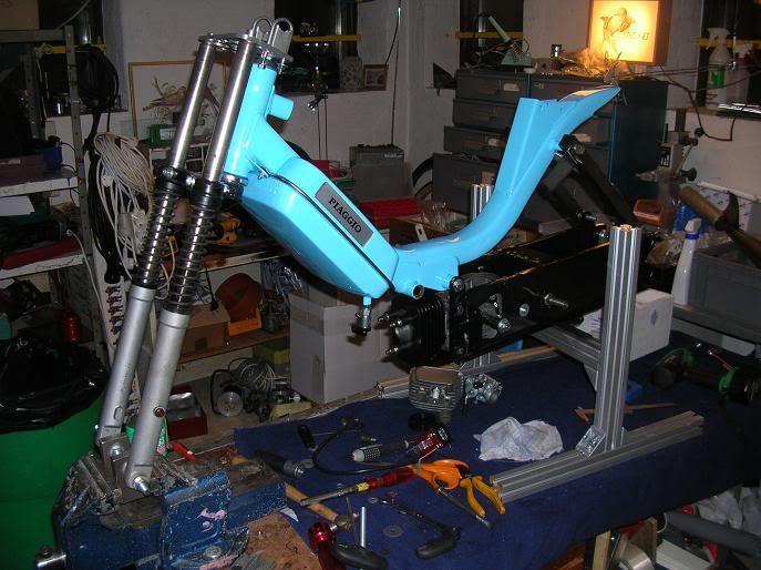

      As you may have seen I´m building a sprint race from a SuperBravo.
      The intention is to build a light but fast, small displacement machine as the rules say maximum 70 cc.
      Becauce of that I will stay with a modified DrEvo cylinder and a PVL ignition.
      You can see more about the machine if you look here and navigate on:
      [url]www.CamaroSS.se[/url]
      I just recieved the frame from the painter and have just began the assembly.
      Here you see some pictures of it:
      As you may see I have put on a new point of where to bolt the engine, 75 millimeters moved backwards.
      On one picture you can see the bracket that will replace the rear suspension, just to keep things in place.
      The assembly moves on and I will update this with pictures as the assembly goes on.

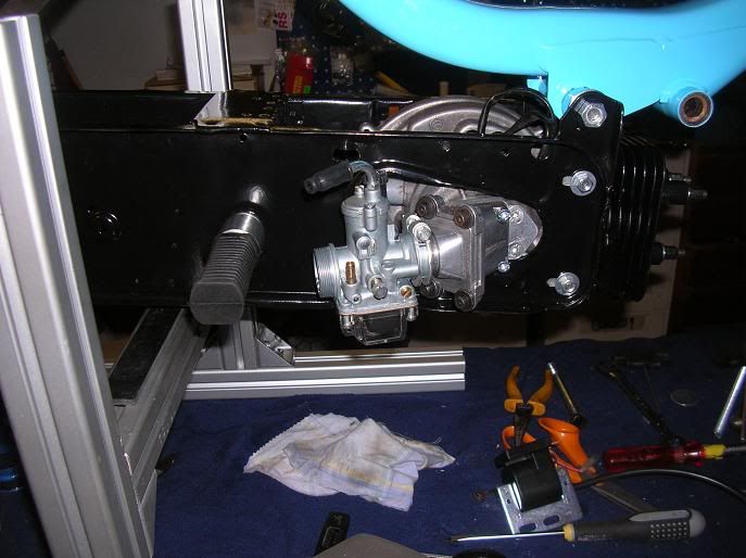

                        The assembly goes on, here from the side where you can see the PVL ignition.
                        I made the hole large enough to give space for adjustment with no clearance issues:
                        The ignition is well clear from the holder:
                        I will have some problems wil my footpegs thou…:con
                        I think I will find another solution to this.

                              May i ask, what sort of pvl ignition is that? (of what bike) And does it already run?:O
                              Because i want to hear it 😛
                              #279056
                              Coolvette
                              Berichten: 107
                                DR-felnny, thanks for your suggestion, that may be my choice, we´ll see in some weeks.
                                beunhaaz, my ignition doesn´t come from a specific bike, it´s components chosen in cooperation with a swedish supplier of those parts.
                                The list looks like this:
                                Magnet/baseplate: 1063
                                CDI/ignitioncoil: 105458
                                Rotor: 940
                                This is not a direct fit, it takes some work to make it fit, the critical part is to machine the rotor with correct angle, 5,5 degrees, and to the correct depth as it is critical.
                                Have a look here, even thou it´s in swedish you may get the idea: http://www.camaross.se/PVL-ignition.htm
                                If you hover over the pictures you can see some comments in english, at least over some of the pictures.
                                All of the pictures will open upp bigger if you clic on them.
                                I will update my site soon but my focus right now is to get the machine ready to run.
                                It´s not yet started so I haven´t heard it but I´m hopful it will run…;)
