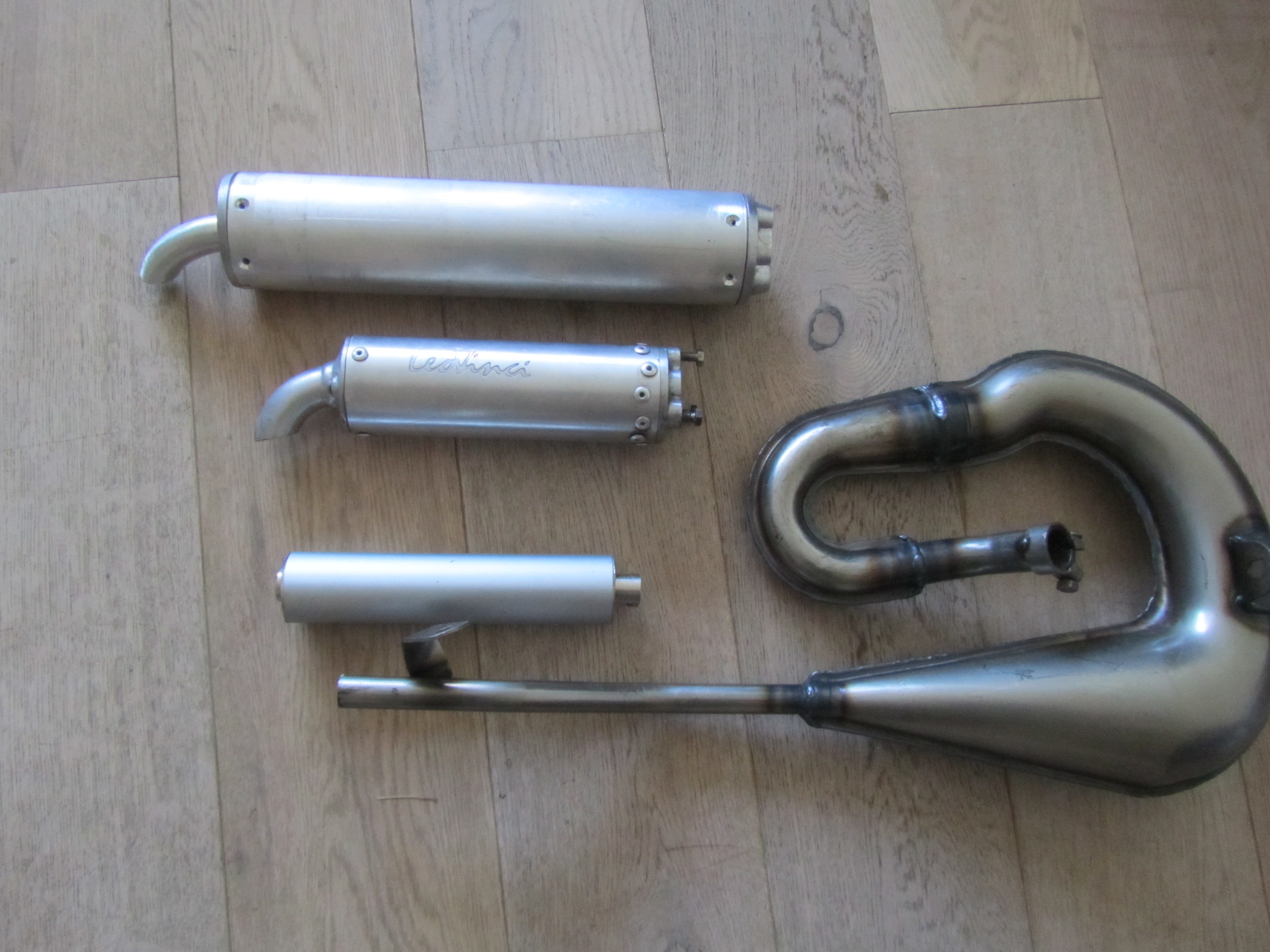

                    Here you can see the diverence between te proma silenser and the leovince silenser.
                    the leovince is way better but also to loud for in the citty.
                    I made a bigger one for a peacefull soud
                    The floor is made of real oak wood :rules
